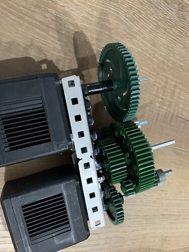

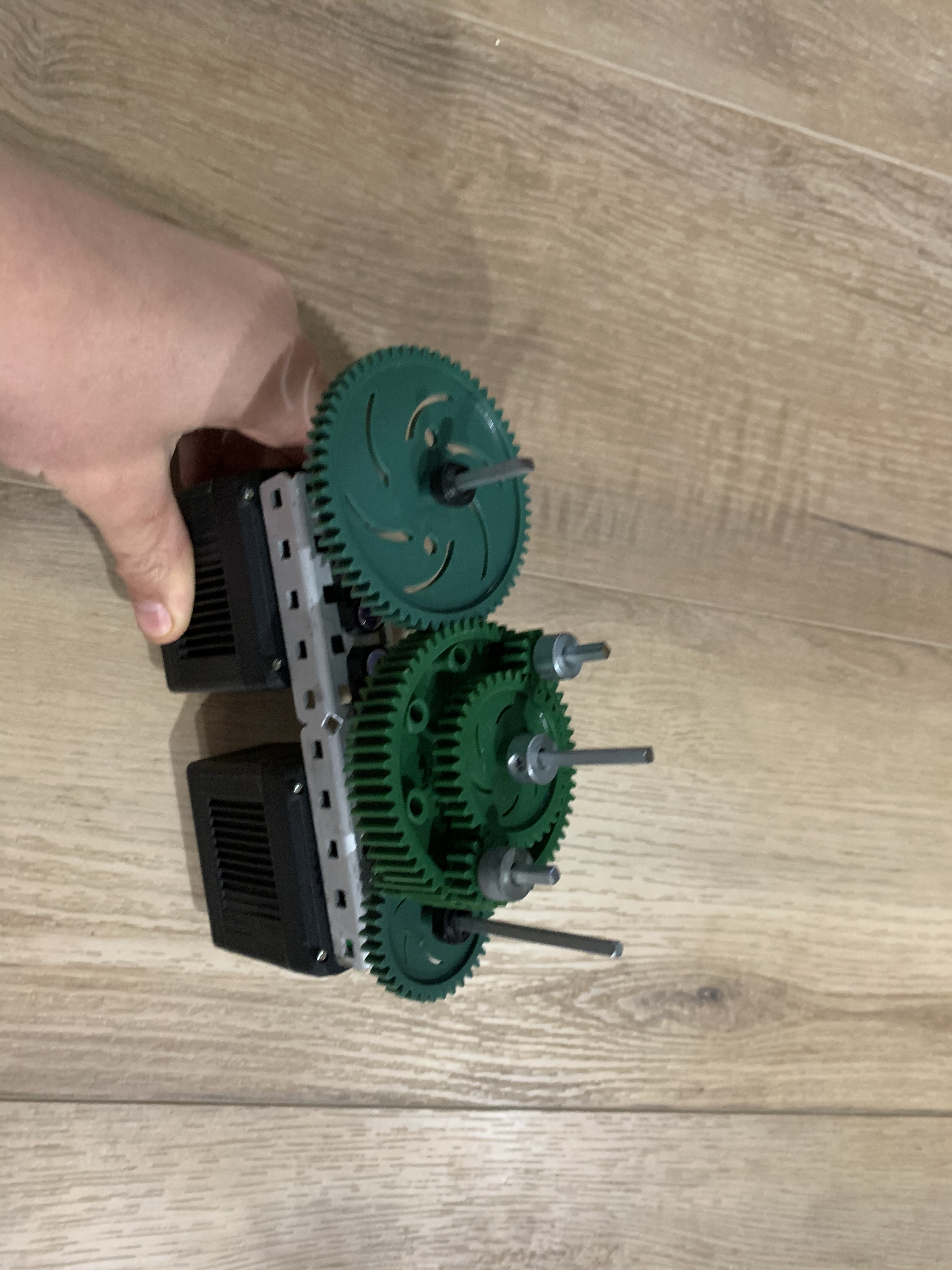

I was trying to make a planetary gear set without a chain but what ended up happening was that the motor that spins the carrier didn’t change the speed and also didn’t contribute any speed to the final outcome. But might contribute torque but I don’t know how to test this.
I’ve already built a working version with the chain and the only thing I did was move the ring gear onto the inside. The only thing that’s connected to the main axle is the 36 tooth normal gear that furthest from the motors. My code basically says to spin the inner ring gear and the carrier gear at the same speed both times except it reverses the carrier gear speed. Which should change the speed of the output. It would be great to know what I’m doing wrong or if having the ring gear on the inside doesn’t work. Also if I forgot to say something then tell me what I forgot.

Would you be able to post a video of it working?
When diagnosing a problem, It’s super helpful to be able to see the mechanism working.
This is not how it supposed to work. The direction of rotation for the 36t gears needs to be opposite, and you have them rotating in the same direction.
You will need an even number of 12t gears between 36ts, like this:
evendiffs
not quite what you asked, but in my experience with a similar setup, those small 12t gears aren’t going to last long in there.

The OP picture has them using the 12 tooth plastic to drive the high strength, this gear would be their best choice. Put an insert into it if you don’t want the larger shaft.
