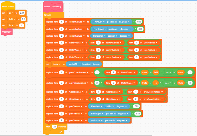

Ive been working more on posistion tracking with V5 blocks and need some more help.
Here is my code
The coordinates being shown on the brain are just wrong. My Y coordinate seems to never change while the X seems to change at the same rate no matter the angle?
