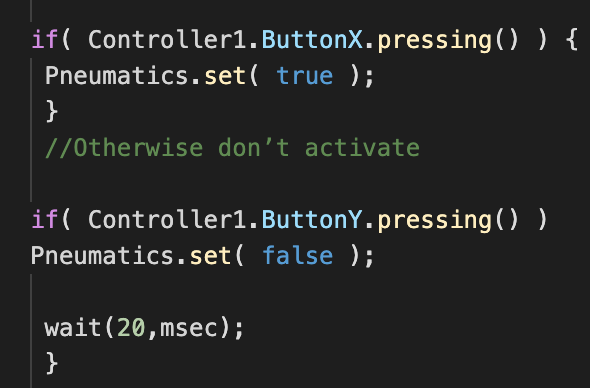

Disclaimer: I am not a programmer, I am a builder who took the robot home for break who wants to test it.
This is the code that we had for our original clamp which was a single acting cylinder. However, I rebuilt it to a double acting cylinder and now nothing happens in the program. I have searched all over the forums and can’t figure out what is wrong with this. Im also aware that you all will likely need to see more of my code, and I can post it as needed. I’m grateful for any help.
Screen Shot 2021-12-27 at 11.25.27 AM
The code for single and double acting solenoids is the same and your code seems to be fine.

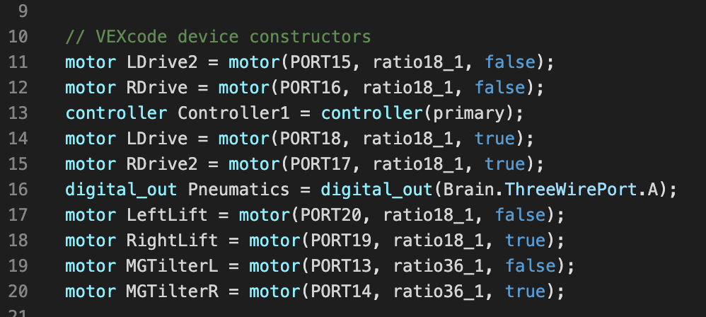

Could you share the part of the code where you are defining the Pneumatics?
Is this what you’re referring to?
Yes, that all seems to be correct. Are you running your if statements in a while loop?
There is a while encompassing all of the driver controls

They are using a digital_out instead of pneumatics. It is correct for digital_out. Here is the api docs:
https://api.vexcode.cloud/v5/class/classvex_1_1digital__out
Could you please post your entire usercontrol code? It looks like everything you posted so far is correct. The issue might lie elsewhere.
