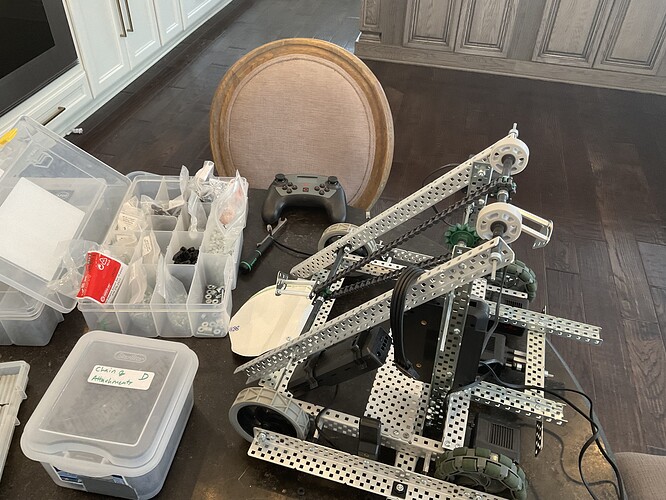

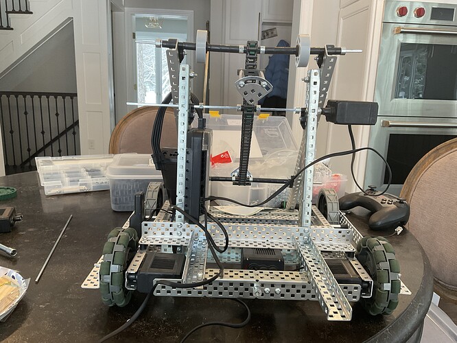

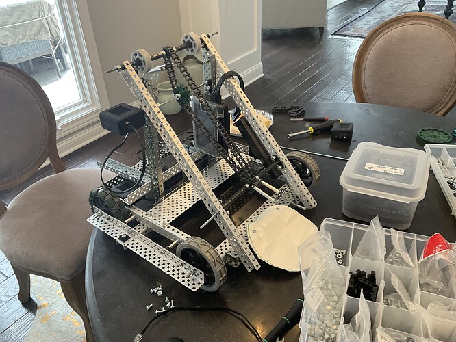

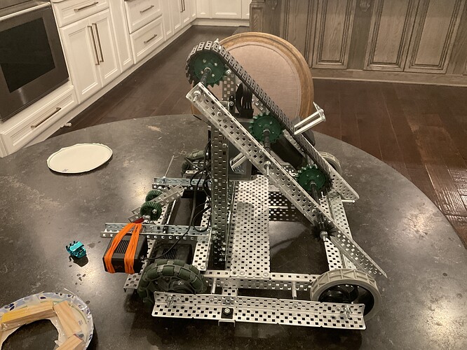

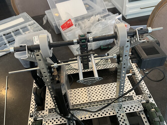

Ok here the photos of the progress I have made so far. I brought it home so that’s why u see the table and stuff. Feel free to give me any suggestions
I would highly higly recommend building a goal clamp now. Fine tuning a mechanism, epecially a hook intake can take a lot of work, since a lot of it is guess and check.
Furthur, i noticed that your top axle is bending in the 4th picture you sent.

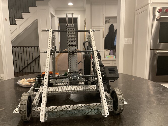

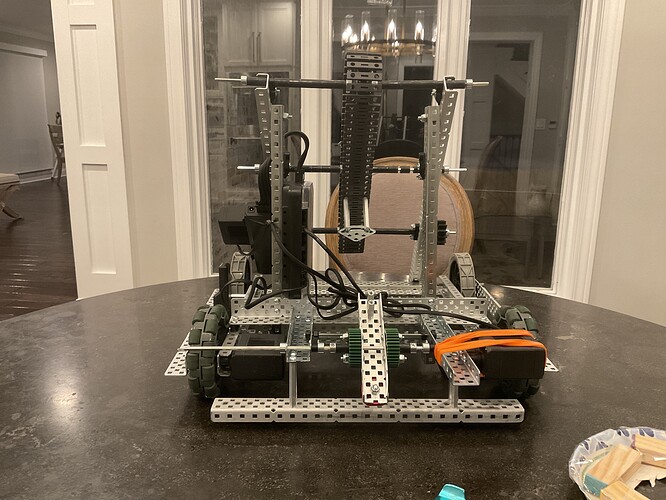

I’m going to send updated pictures of what I changed I changed a lot including the whole intake mechanism

I was also having this exact same problem where my axel was bending on the top of my intake. Do you know any ways to permanently fix it, because right now we are just taking the axel off straightening it and putting it back on and this isn’t the most efficient use of time for us.
I can’t tell if that’s a 2 motor drivetrain, but I recommend using 4 or more. A 2 motor drive will overheat super quickly and be super weak, making it hard to defend goals in corners.
It’s my first year in robotics and I only have 2 weeks before a comp. . First there’s this bar in the middle under the robot my intake is mounted to that bar for support so I can’t remove it. Second if you look at the robot on vex v5 website on the online build instructions you can see that it is hard to mount 2 motors on the front I’m going to try the make a 4 motor drivetrain but it would be without gears. Last of all I have a lot of testing to do since I brought my robot home. I have made a goal clamp but it still needs testing Im gona test my new intake and goal clamp today
In my new picture the axle does bend a little too but there is almost little to no friction it runs smooth
use a high-strength shaft or you might wanna use the same size sprockets. If you have pictures of your robot can I see them?

there are 2 way that I’ve used
  1. move the c channel or put a smaller c channel on standoffs connected so that the low strength axel has less room to bend
or even better
  1. Use high strength shaft.
Just started doing that today
Yes high strength shafts are great but if not I recommend using same sized sprockets and your intake kinda like mine.
