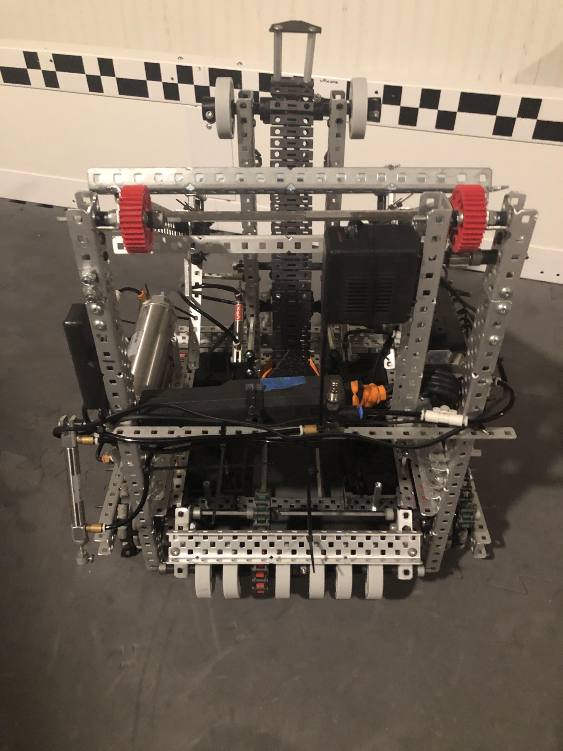

Any things I could improve on with this robot? This was built in a week for a competition in November and I want to make sure everything is “good” before I begin to code.

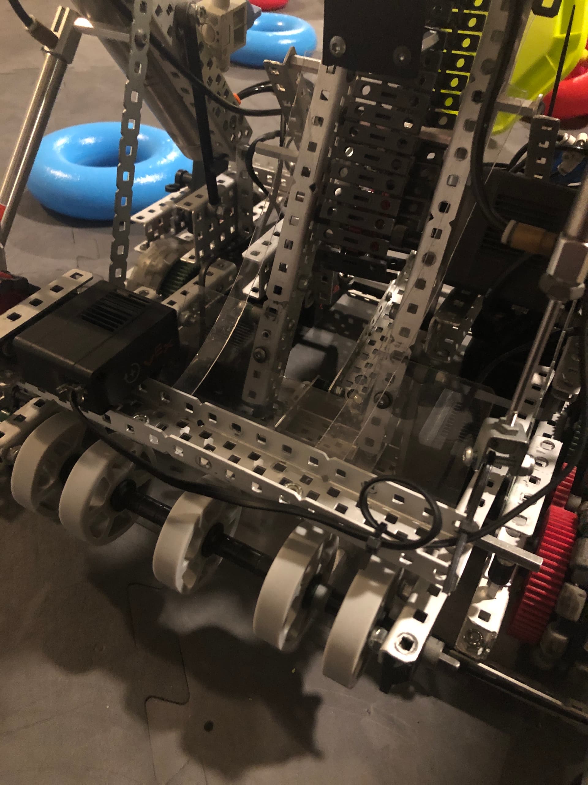

  1. Fix cable management, don’t want to accidentally get entangled or get a motor unplugged.
  2. Add a connection at the front of your drivetrain, like an L channel or a standoff

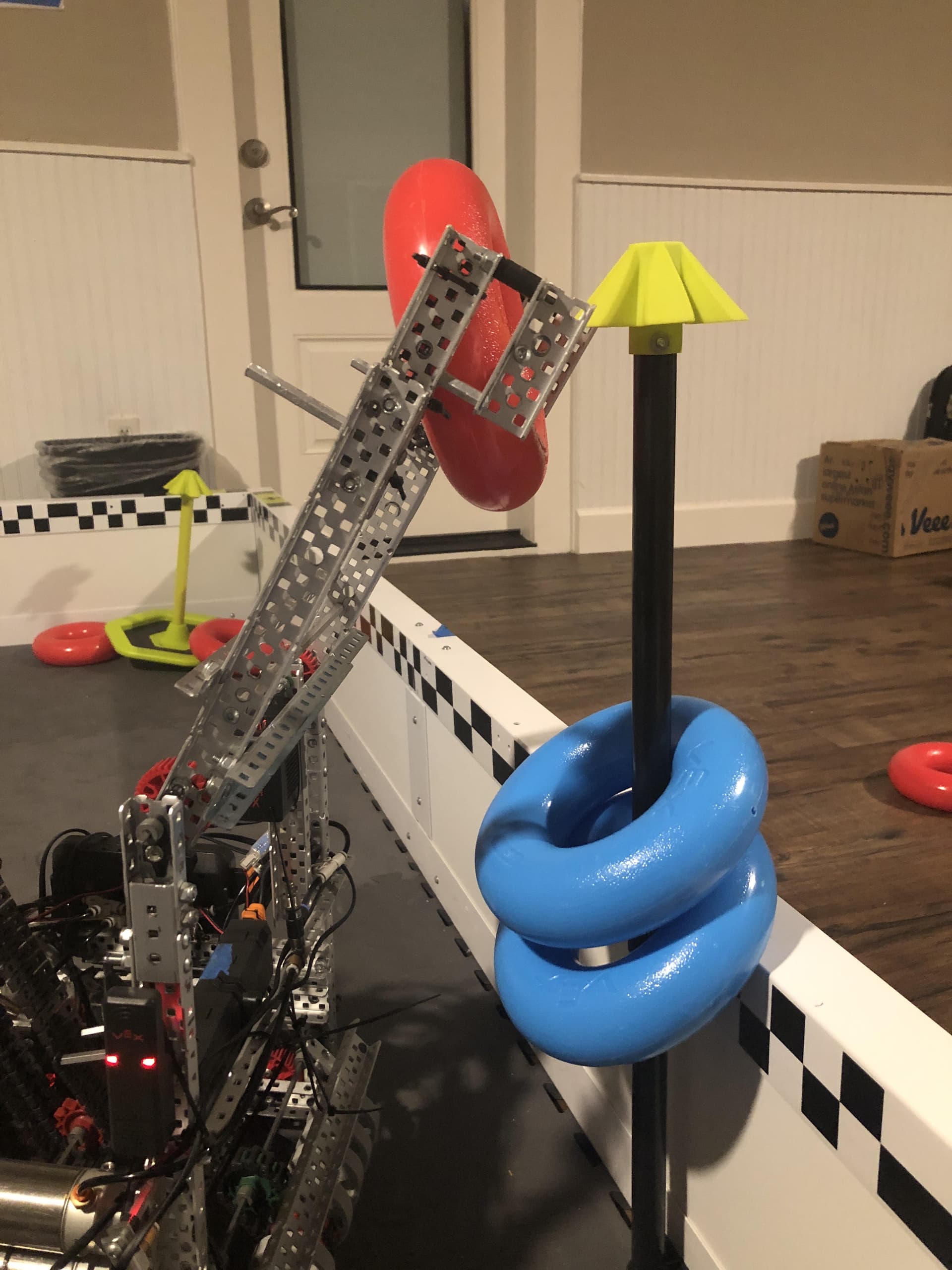

  3. I feel the arm is a little too short for the high stake, maybe after comp you should rebuild it to go higher
Definitely fix cable management. You don’t want a hook to rip the cord out and you need to be able to find which cables connect to which motors/sensors fairly easily. Overall though, it’s a good robot; just fix that and begin your coding. :slight_smile:
Thank you all for the advice, we fixed everything and ended up winning Tournament Champions :smiley:
  1. Put some more friction on the lady brown mech
  2. make arms longer
  3. more support
  4. quality control
change the steel bracing o th lady brown to aluminum

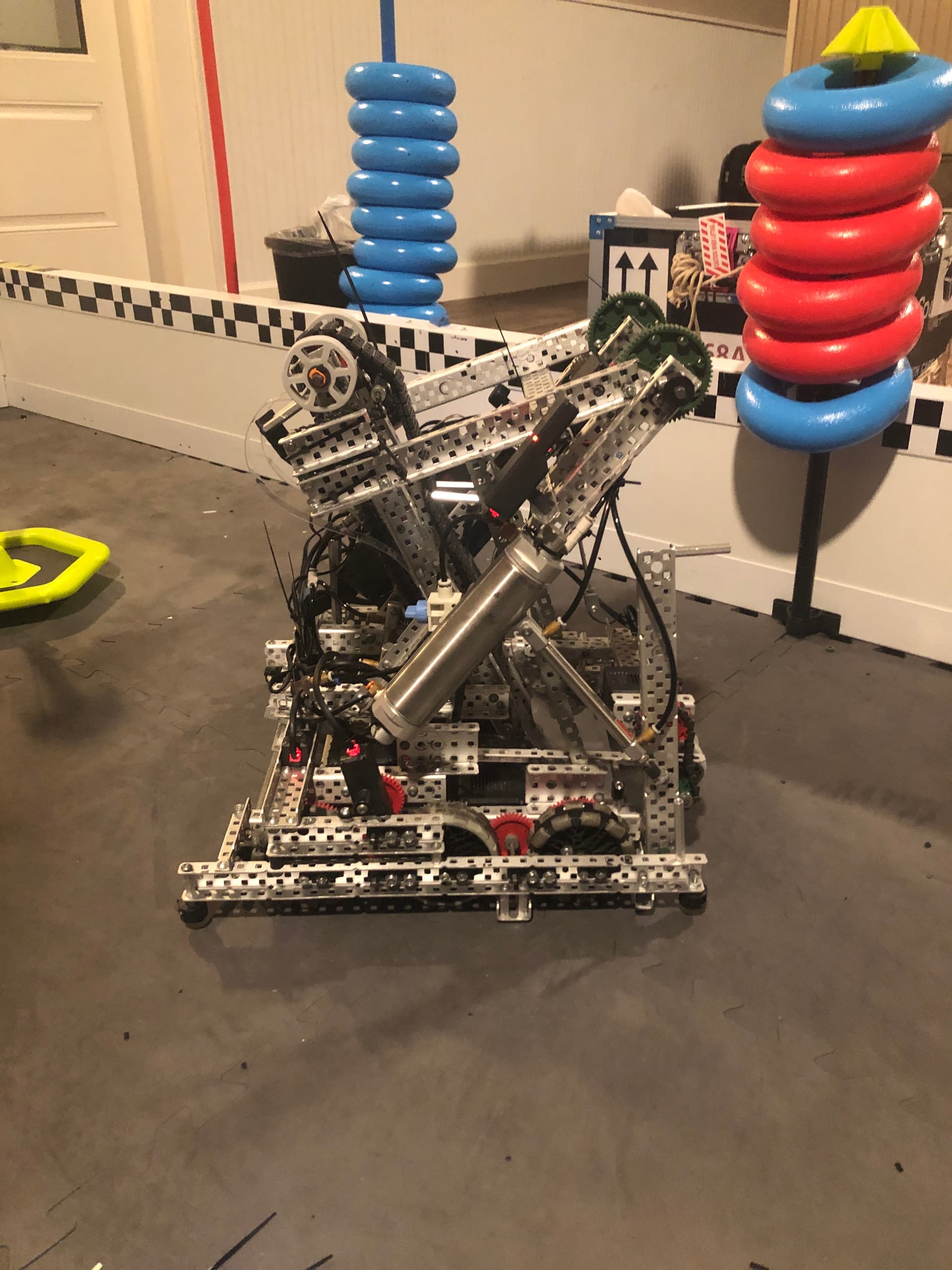

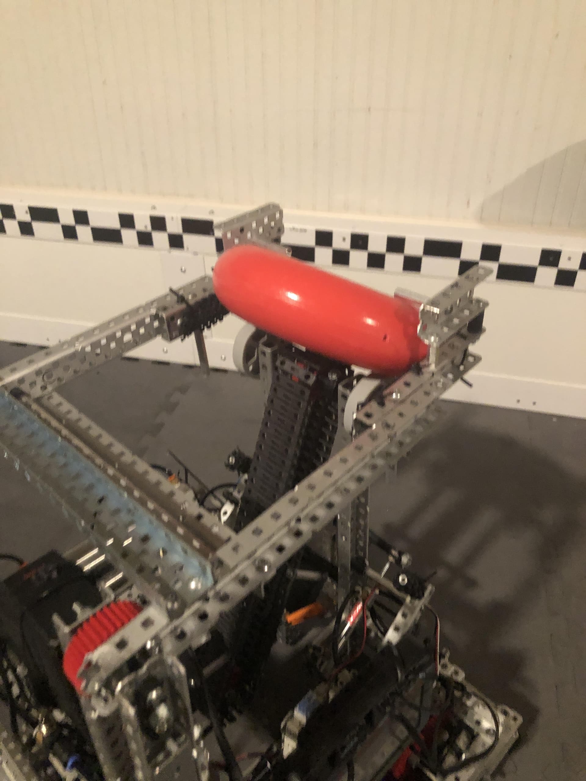

Hi, back with another robot, any build tips or suggestions?
Stats:
360rpm 66W drive
11W 600rpm hooks
5.5W 600rpm preroller
5.5W 80rpm ladybown
2 piston clamp
1 piston doinker
note
If anyone wants more photos just ask, I’m fine with sharing my robot online (holecount if you like)
That look’s really good, I think best is just driver and programming work since that bot looks pretty good right now. If possible I’d probably go just a bit faster with the drive train (400rpm maybe), however that doesn’t look bad at all. Depending on how your events rule it maybe trying to make that into a 4 ring doinker. I cant really see it but how’s you mogo clamp.
Very solid bot, just practice and little things now.
