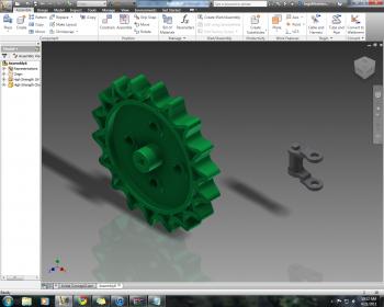

[ATTACH]3976[/ATTACH]
  1. Open up your Assembly, and Import your High Strength Sprocket (size of your choice, I’m using the 18-Tooth Sprocket for this demonstration) as well as your High Strength Chain Link. (as shown in the picture above)

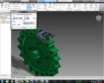

[ATTACH]3979[/ATTACH]

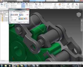

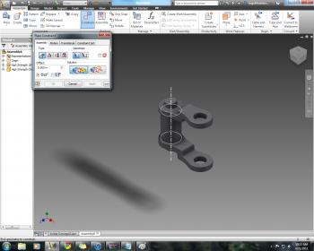

2. Click the Constrain Tool. This tool will be very useful for building robots in Autodesk Inventor, so you should get familiar with it if you aren’t already. Once the Constrain tool window pops up, the first thing you want to click on will be the axis shown (in white) in the picture above, on your High Strength Chain Link.

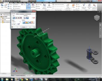

[ATTACH]3982[/ATTACH]

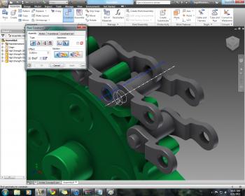

3. Click on will be the axis shown (in white) in the picture above, on your High Strength Sprocket.

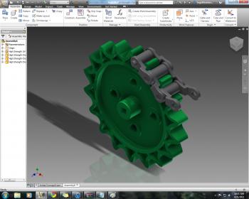

[ATTACH]3985[/ATTACH]
4. Click the “Apply” button on the Constrain tool window, and your High Strength Chain Link should be mated to your High Strength Sprocket, just like it is in the picture above.

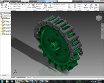

[ATTACH]3988[/ATTACH]
5. Simply repeat steps 1-4 for all your Chain Links.

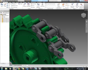

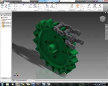

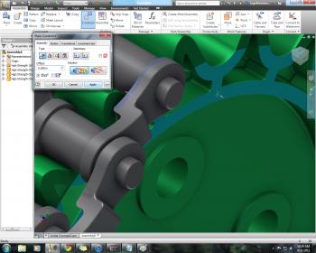

[ATTACH]3991[/ATTACH]
6. Notice that the Chain Links are mated to the Sprocket, but are not yet connected to each other. To do this, start by clicking the axis shown (in white) in the picture above, on the first High Strength Chain Link.

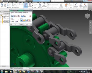

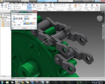

[ATTACH]3994[/ATTACH]
7. Click the axis shown (in white) in the picture above, on the next High Strength Chain Link.
[ATTACH]3997[/ATTACH]
8. Click the “Apply” button on the Constrain tool window, and your High Strength Chain Links should be connected.

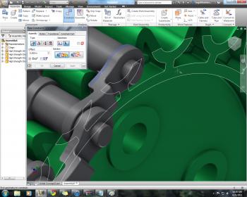

[ATTACH]4009[/ATTACH]
12. Before you click “Apply”, Change the “Offset” to “0.008 in”. This number is a good centering offset amount. Now you may click the “Apply” button on the Constrain tool window.

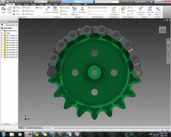

When you are finished, your model will probably look something like the pictures above and below, with the Chain Links mated and connected around the Sprocket.
[ATTACH]4018[/ATTACH]
Once you have finished this, it should be straightforward as to how you will connect chain together to reach your other Sprocket, and wrap it around that one, making the chain come back around to create your end Chain/Sprocket assembly.
