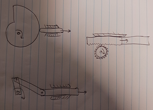

Here are three common mechanisms that convert rotary motion to linear motion. You’ll need to work out how to build them using VEX parts yourself.
If I were you I would go to YouTube to go look at other teams indexers.
I don’t have some of the parts you showed me so i could only do the bottom one but thats already a system i tried and was a little slow for me so i found another system but thanks for your suggestions anyways :+1:

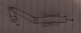

For those that are stumbling across this thread.
#3 shown above appears to use a metal plate mounted on a motor shaft.
Doesn’t have to be a plate, can be a gear. You can could the linkage to one of the holes around the perimeter.
