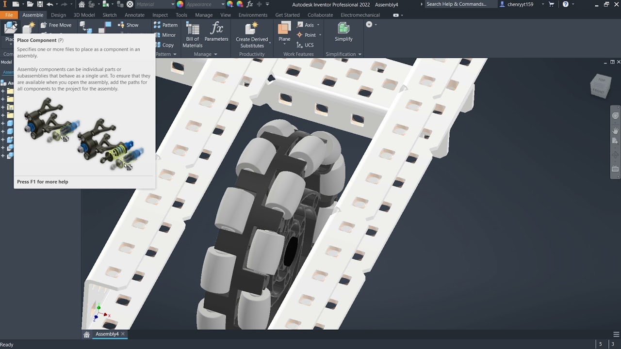

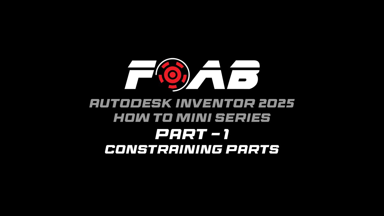

The last part I can’t help you with because I have no experience with Autodesk Inventor, but resources like these show the basics of using it for VEX. Hope all of this helps!! Good luck!
