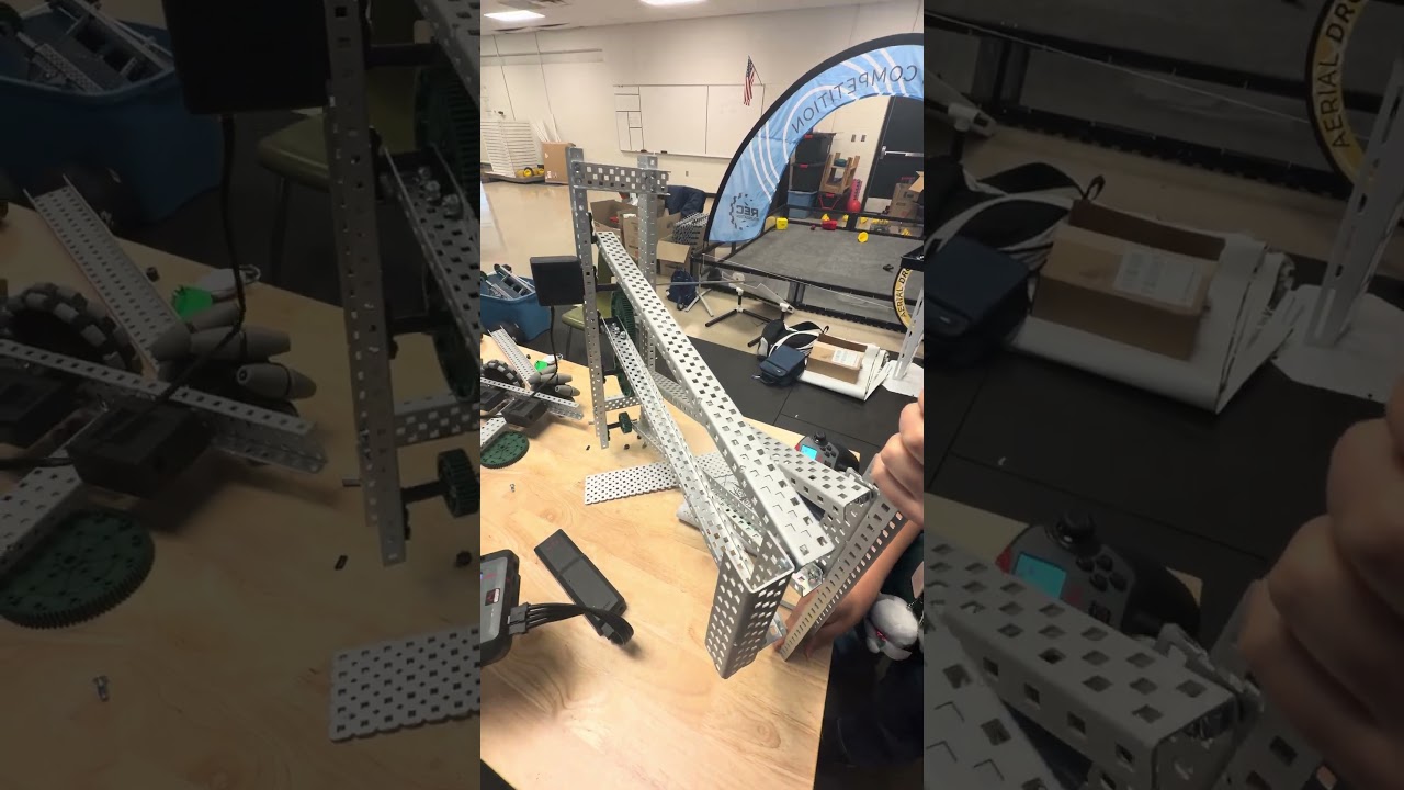

How can I fix this in my dr4b
How can I fix my dr4b? The gear doesn’t appear to be catching the teeth, and I’ve already added supports on both sides

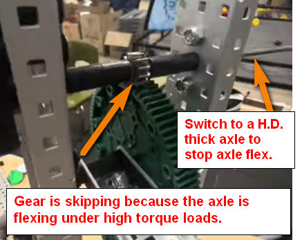

The gears are skipping because the axle is flexing. Remove that thin axle and replace it with the High Strength axle. Also use the HS pinion gear. It will spread across the green gears a bit more. That extra surface area will increase tooth contact between the green gears and the steel gear. That will also prevent skipping.

Unfortunately, I don’t have access to a power drill. Instead, I resolved the issue by adding rubber bands to the arms. Thanks to everyone who helped!
Glad rubber bands are helping.
Another (admittedly janky) option is to zip tie around the motor and gear axles to keep them from flexing. Adds friction, but stops the skipping.
