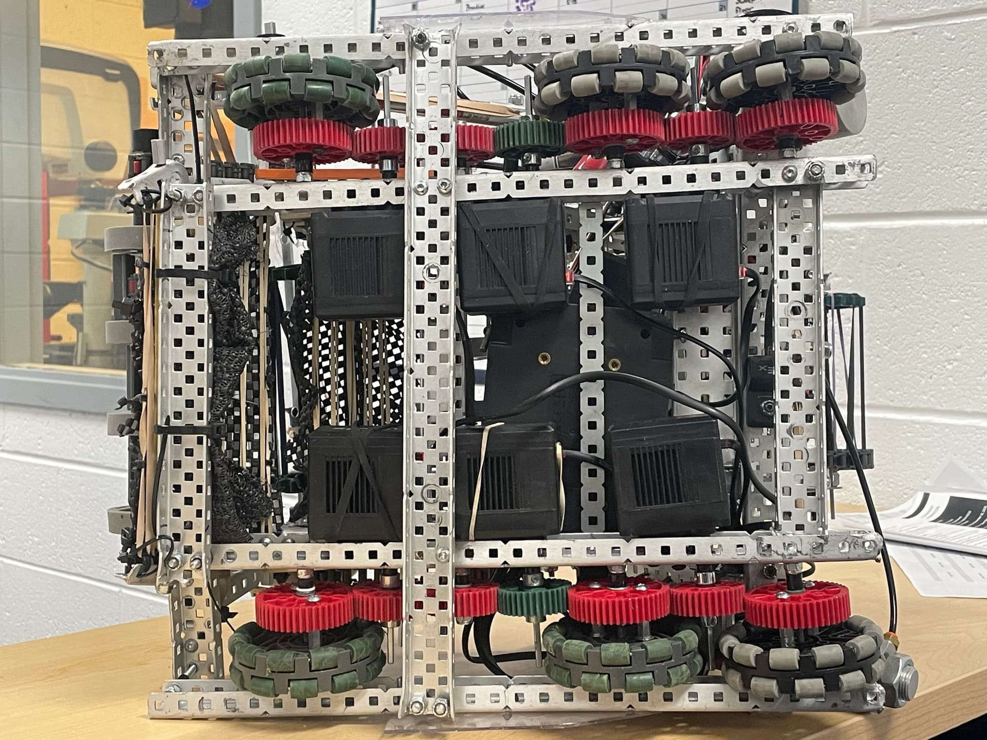

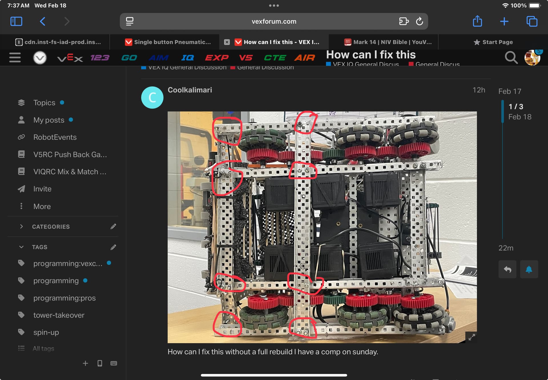

How can I fix this
How can I fix this without a full rebuild I have a comp on sunday.
I would take off all the drive gears, motors, and wheels. Then shove your bot in to a corner to make it square again, then reassemble the rest.
Also I would extend those shafts so you can put bearing flats on the opposite drive channel and support them. If you have time also box bolt your drivetrain braces.

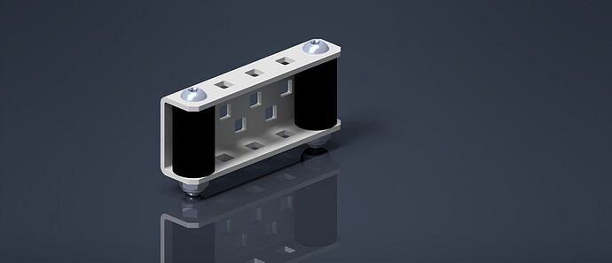

could you expand on box bolting?
I assume American means using a long screw going across the c-channel at intervals, which is filled with spacers and secured with a nylock on one end, to provide more support for the braces and to stop them bending/distorting upon impact!
This is box bolting.
You can use it when you attach the c-channels together to make it less likely to bend.
box bolt here

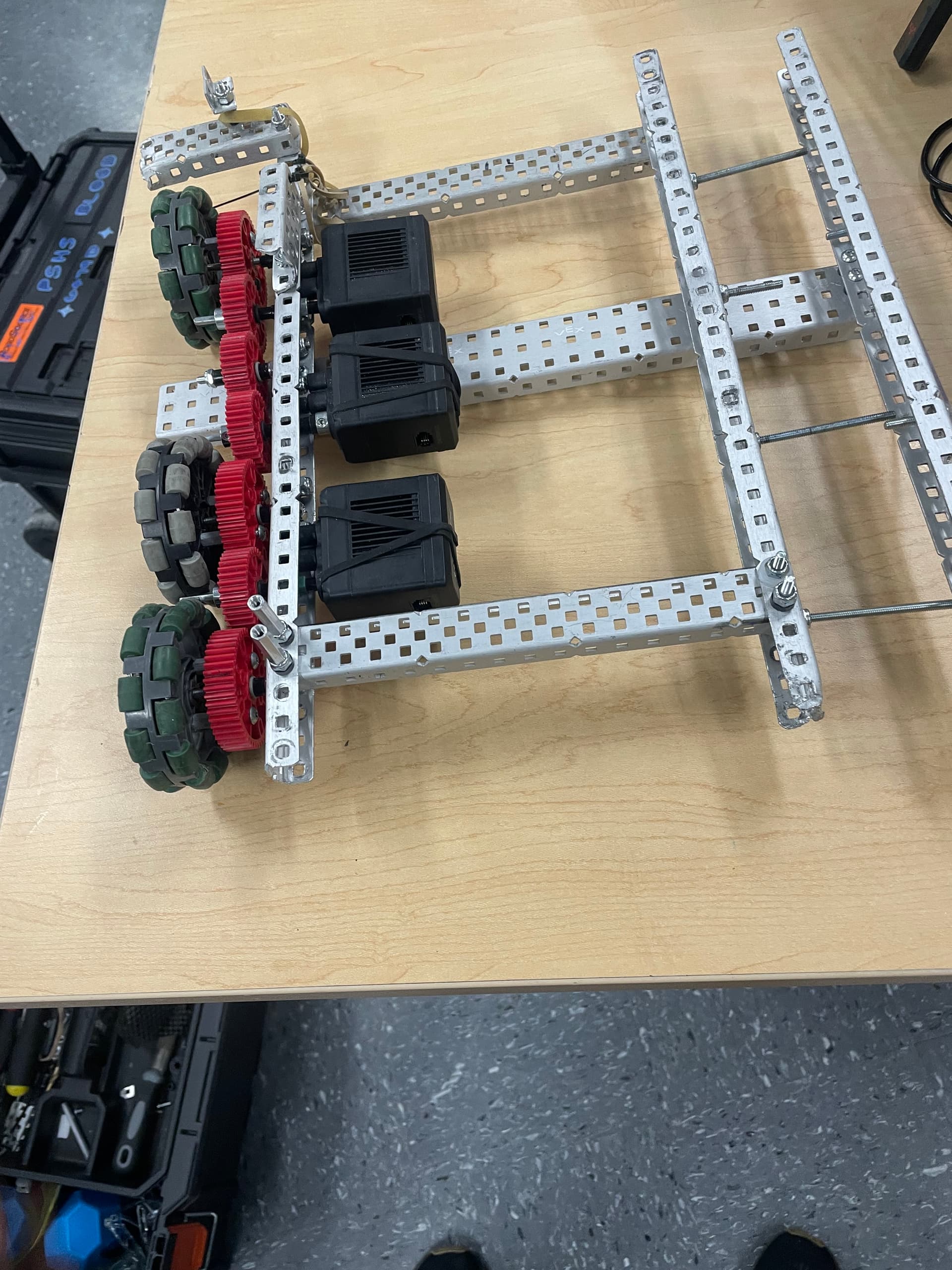

this is the rebuild how is it looking we still have a crossbrace to put on
are those long screws on the side without wheels ? Are they 2.5 inches or less long ?
they are infact 2.5 inch long screws
If you mill a vex v5 high custom strength shaft, you can make a legal screw that is 30 inches long

Am I interpreting these pics correctly?
  • All of the axles on your drive base are cantilevered from the inside rail.
  • Drive gears are on .125" axles only supported at the motor (some/all without a bearing flat for the axle).
  • All driven gears are cantilevered screw joints. 2.5" screws for wheels.
I would imagine that the points above will result in a drivetrain with a lot of movement/slop that wastes quite a lot of power once a full-weight robot is sitting on top of it. (One of my newer teams just fixed similar issues with their drivetrain.)
What is the purpose of those two (5/8") screws pointing inward from the outer rail on your in-progress rebuild?
Do you mean 24 inches?
More feasibly, you can run an 8-32 die on a .125" shaft and get enough thread (though with flats) to hold a nut.
Yes, 24” HS shaft (20 char)
