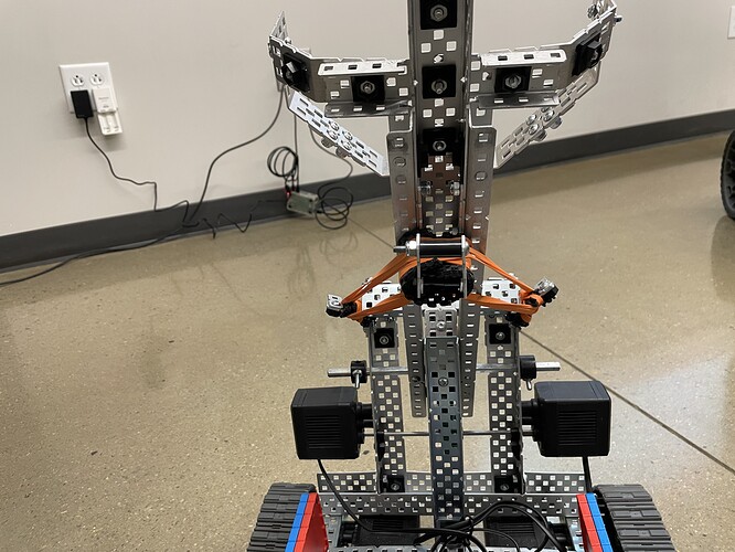

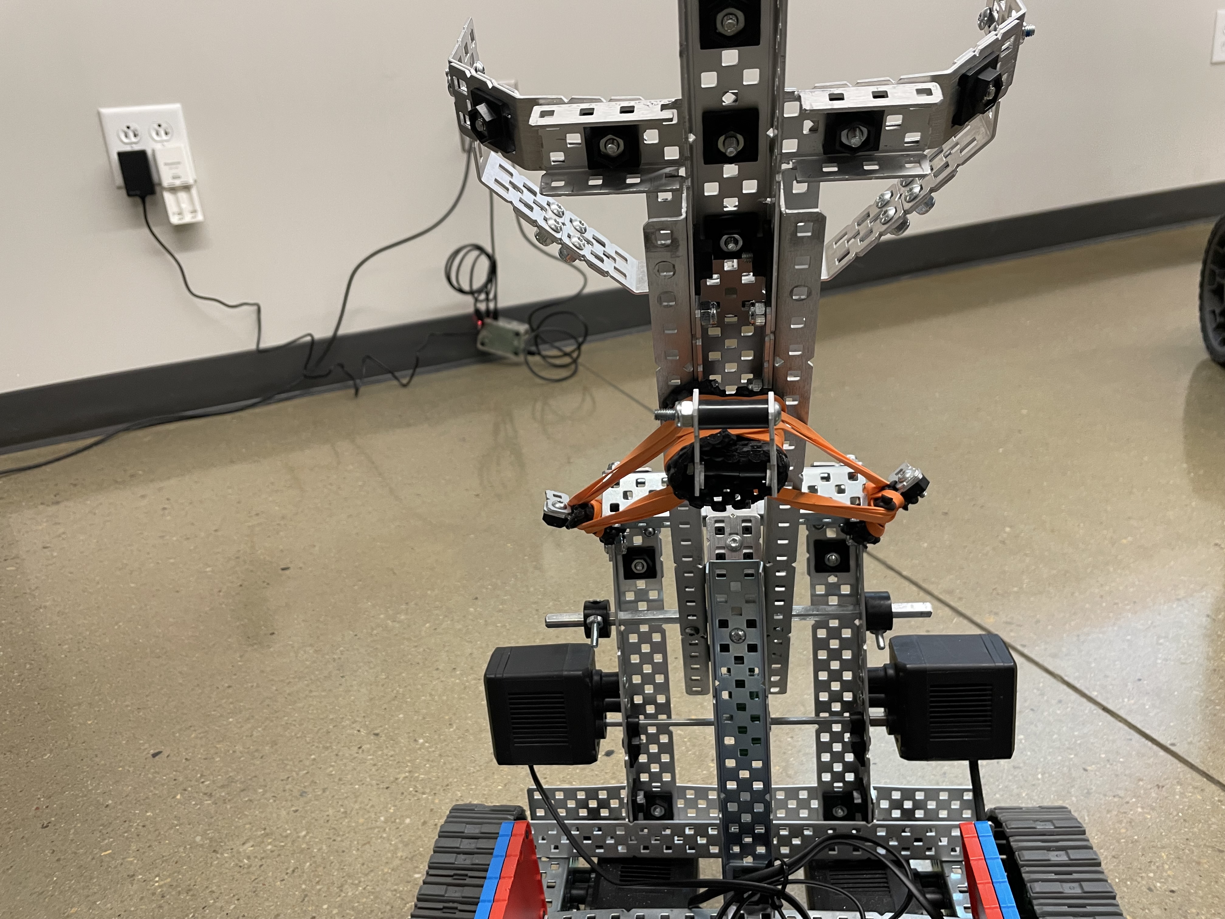

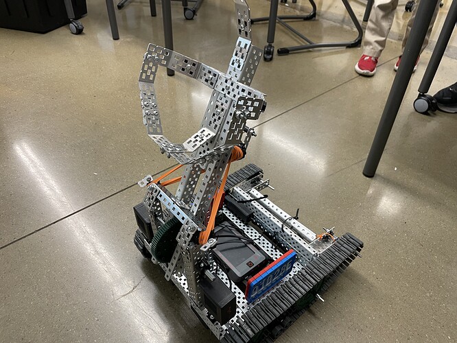

How can I improve my bot
I made a catapult bot but it has problems with it I need help to figure some out and how to fix 'em.

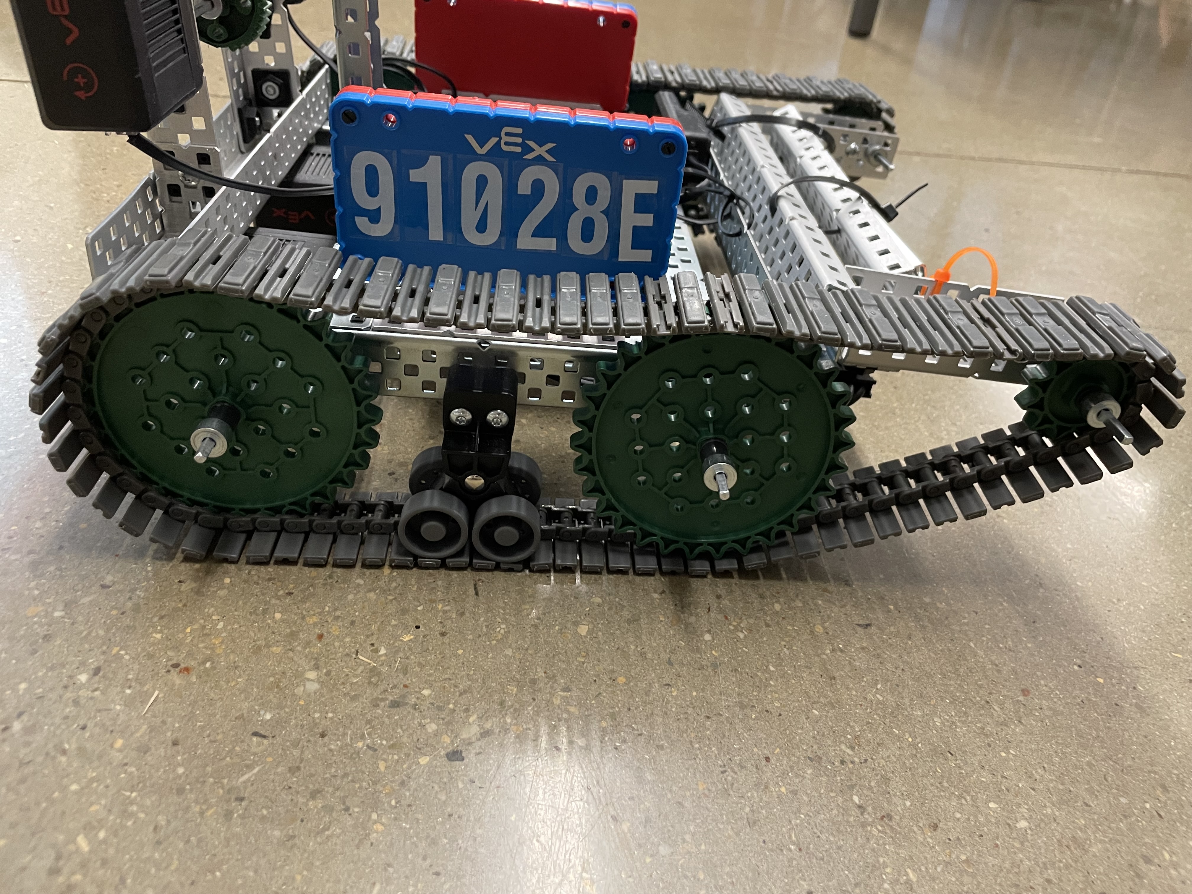

I have pictures below and a link to something with videos of some games because I can’t put them on forums. I am very aware of the treads though I’m in the middle of fixing that.
Past Games

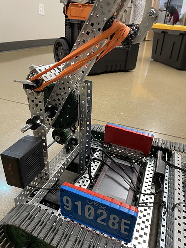

-Use bearings on all places where the shafts (low strength and high strength) go through metal. Especially where your catapult pivots and on your drive.
-Don’t use steel too much on your robot, as its very heavy. It is good for parts of the robot being put under lots of stress or force, like a catapult hard-stop or the catapult arm.
-Make sure you support any moving joint (shafts or screws) on two sides to prevent the shafts from bending, especially on your drivetrain.
-Make the catapult wider and maybe a little shorter, by having a wider catapult around the same width as the triballs you don’t need to make a holding tray at the end of your catapult, which reduces the overall speed of the catapult when it is throwing the triball.
-Make the catapult a bit faster, when my team had a catapult we geared it 12:33 so it spun the catapult at 33rpm, we found the speed and strength of this gear ratio to be very good for matchloading.
-Box anything attached to flanges of the C-channels, do this by placing 7/8" of spacers between the two flanges of the c-channel, I’ll leave a video explaining this and other building concepts below.
Despite some of your flaws, you still have a very decent bot and trying to make your robot better is the true spirit of a vex competitor. Changing parts of your robot allows you to learn more about other building techniques.
If you want or need any further help my discord is bbfarms#1524 I would be very happy to give you some tips and help with anything robot related.

On another note, as you try to change your drive base to use wheels, I would recommend looking at this Catalogue of Drive Gearings for different geartrains. I would recommend switching to at least a 4 motor drivebase, as that is the competitive minimum. For this game, I think that it’s necessary to have a drivebase with your wheels relatively close together if you want to be able to go over the barrier. I would recommend checking out 450 RPM on both 3.25in wheels and 2.75in wheels, as well as 360 RPM with 4 3.25in wheels.
As for general advice, I think that @91416N’s advice is very good with 1 minor exception.
12:33 gearing doesn’t exist, so I’m assuming that he meant 12:36. Your catapult appears to be plenty fast (the same speed as 12:36 gearing; catapult speed is correlated to the speed at which the slip gear spins, so if you power the slip gear with a red cartridge it will have the same speed if you don’t account for torque), as I have the same design (36:84). If you do decide to rebuild, I would recommend switching to a 12:48 gearing, a 24:72 gearing, or a 12:36 gearing to give the same speed of launch while having more torque to pull back on the catapult with, but other than that your robot appears to be really good.
