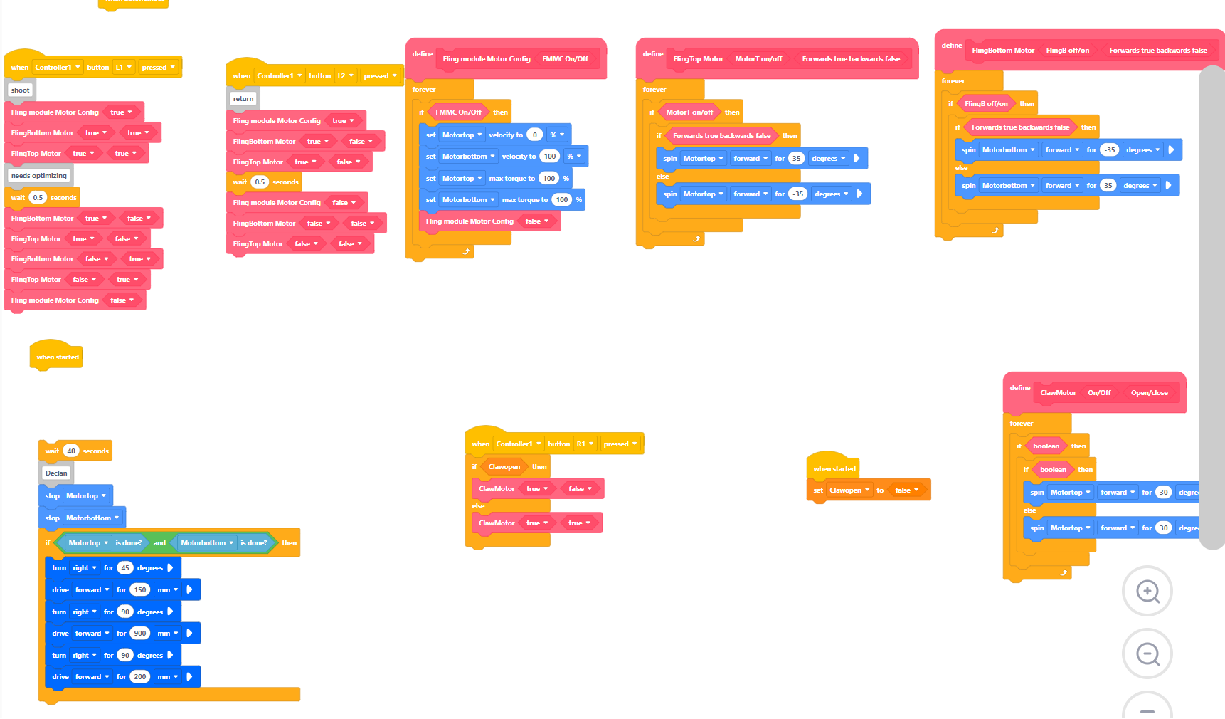

I haven’t currently got a code that this effective and works at the moment however, I do have a rough old code that was used and was not affective. The robot had a flinging mechanism to shoot the tri-balls onto the other side and get 2 points. We also had an elevation claw however, we shortly got rid of that due to effectiveness.

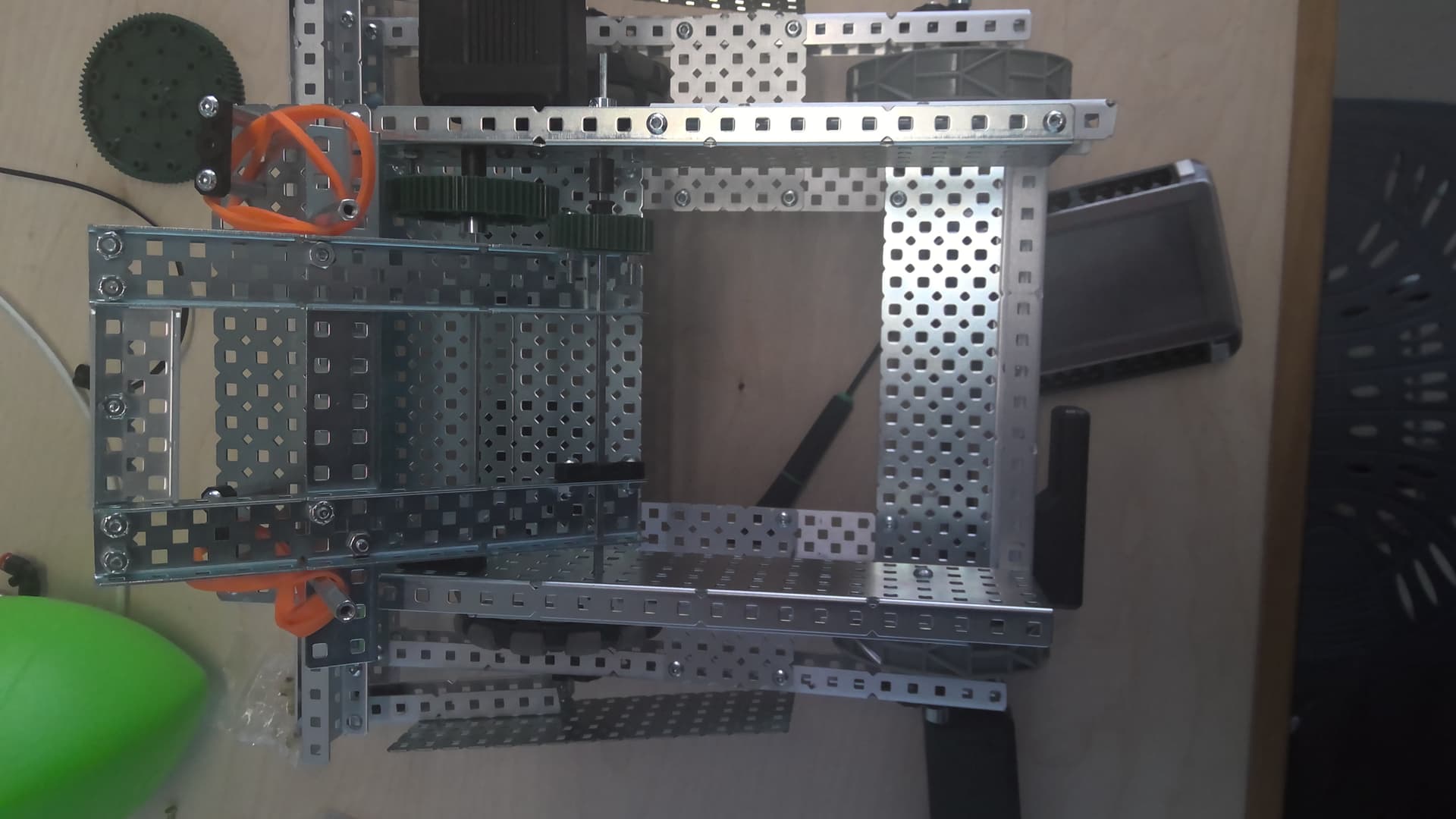

Our team has not had that must experience driving so that could be part of how difficult it is however, the speed for the motor is so fast that they just crash into things.
The robot is around the size of this photo attached and the code is also attached!

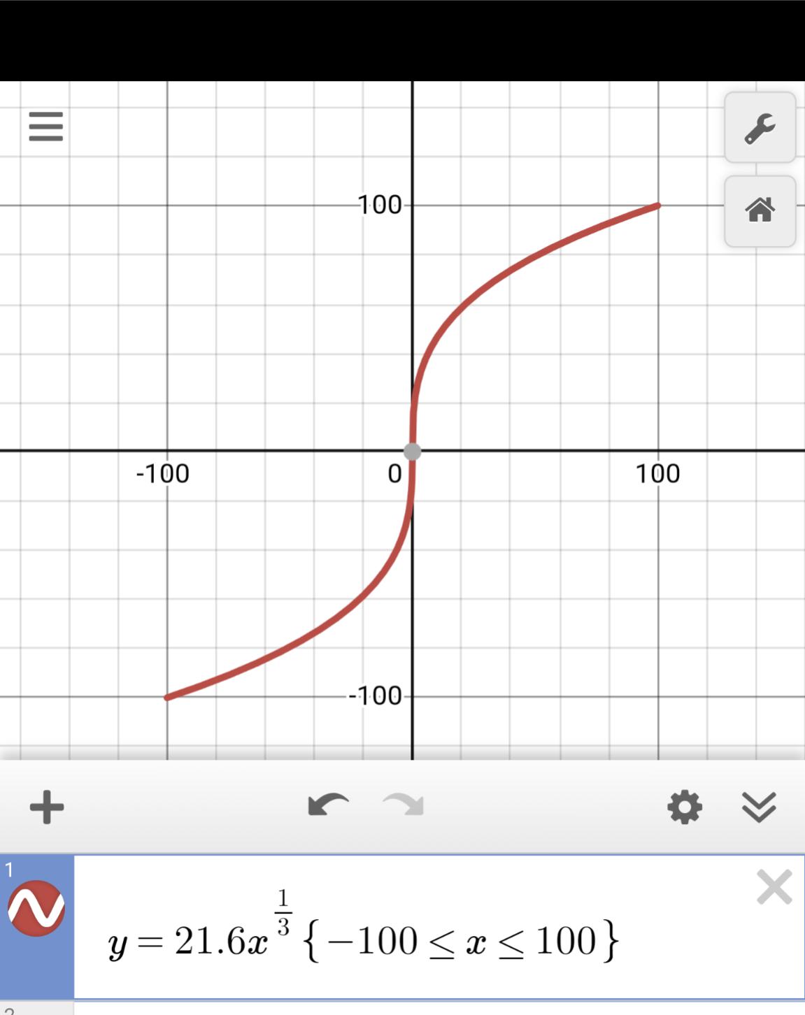

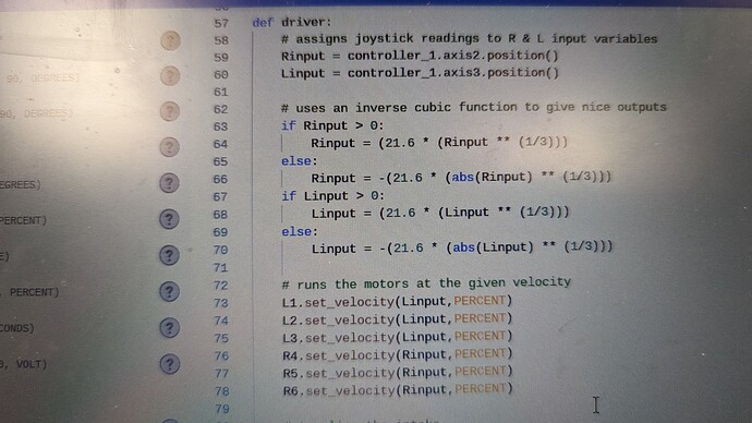

This is a topic I’ve worked on for a while with my programmer. We have decided that an inverse cubic function is the best. Currently, our function is y=21.6x^(1/3). It is awesome, and makes driving at medium speed very easy, and even makes it easier to drive straight at low speed values. We tried using a regular cubic but found that it made driving more difficult, because it was more sensitive, and tougher to land at a good medium value. This is a desmos of what it looks like.
And this is what it looks like in code
I hope other teams find inspiration from our findings!
