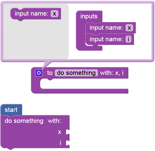

So I’m using Blockly in Robot Mesh for VIQ. My goal is to replace the “Turn (direction) Power (power) until Angle (degrees)” with a custom function using the gyro sensor. In order to do this though I need 3 parameters: direction, power, and degrees. But when I click the settings icon for my “turn_with_gyro” function it only lets me define one parameter. Any ideas?
Drag more inputs into the function in the configuration popup:
