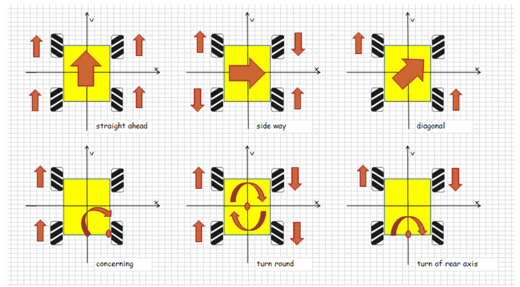

I cannot strafe with our robot’s mecanum wheels. I have tried countless things, and they simply do not strafe, no matter what. I can grab my code and maybe an image of my robot later, but in the meanwhile can anybody give me suggestions?
Make sure your wheels are in the correct positions. They should be aligned like this:
I can check this tomorrow. Also, for clarification, is it different if I use the green mecanum wheels? (see image)

Whoop, nevermind, I just found an image in our notebook. They’re aligned backwards! I’ll consult my team, I think they’ve been like this the whole time…

For code you probably want this:

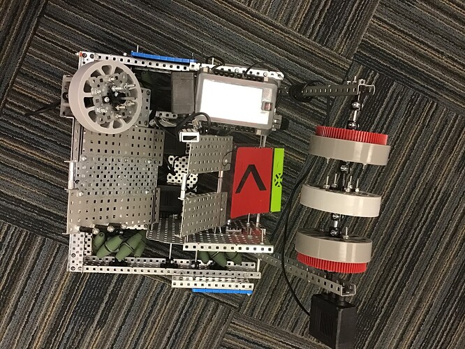

Picture of the bot.
The intake generally doesn’t touch the floor, whatever direction. However, since the front wheels are acting strange when strafing, the robot shakes side to side, like it used to when normally turning on normal code before the wheels were fixed.
We fixed our wheels, then we tried this code, and also a code that we were given by a team that formerly used mecanum wheels (same code, but Axis2 was replaced by Axis3)
They didn’t work, so we put them both in a forever loop. Then they started driving. It kept driving in really strange, inconsistent ways, like how it did before we fixed the wheels. Also, we couldn’t strafe either way, even though our wheels would be spinning the correct directions. We don’t know the problem, but we have mostly narrowed it down to either too much weight, bad weight distribution (heavier in the front) or our front wheels locking up. Let me try to get a picture.
Yeah, a picture would help. Are you driving it on the field or are you driving it on a different surface?
Both, it seems. Also, there is a picture, took like 2 hours for the mods to approve it tho lol
