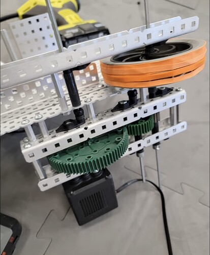

How do I get more speed out of a blue cartridge motor for flywheel?
Currently running a blue cartridge motor with a 7:1 gear ratio for flywheel drive. I tried a second motor but that didn’t add much more speed at all so we took it off.
Speed will be determined by the gear ratios you use. Assuming that “full speed” was obtained by the first motor, adding a second motor would have no effect on the speed, but it would increase the available power–meaning that after shooting a disk, the flywheel would come back to full speed more quickly.

I did some research and the maximum speed achievable by a blue cartridge is 600 rpm. I am only getting about 450 out of it. Is there a way to increase the power/speed of the motor. Another idea i had for shooting it further was using a pneumatic cylinder to push the disc into the flywheel but the pneumatics I ordered wont come in until next week
When coding I can increase the output speed of the motor so i can get the 600 rpm out of it but in driver control its not spinning that fast
I’d say the most likely culprit is friction. Are there any photos or videos you can provide?

These pictures are from today. We were not getting enough speed to launch it far enough, because the wheel is considerably heavy, and we causing too much friction, even with the bearings.
We used lithium grease to solve this, by putting it on the shaft at contact points.
We are using a 7:1 ratio, with a 600rpm motor. This is well over enough to launch it across the field when at max speed. Friction we found is the largest issue.
