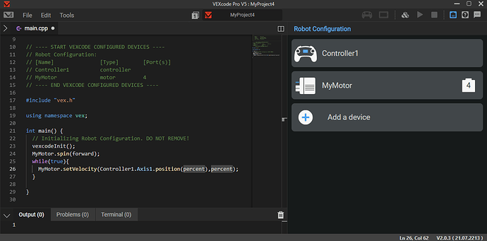

Add a controller and your motor in the Devices tab. Then set the motor velocity to the controller position as the value.
Edit: Oops, Ill use VexCode Pro for my screenshot.
if you’re using text, can’t you just add:
MotorName.spin(forward, Controller.Axis#.position(), percent);

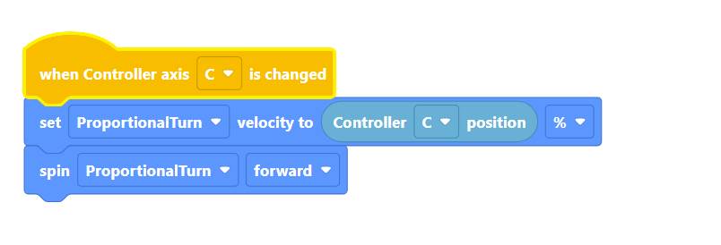

Great to know this is possible, but using this would require a permanent conversion to a text project, right? I don’t see any way to edit the code without converting to text, which my 5th grader doesn’t want to do. Is this right? Thanks!
Ok apparently it is possible-- found on another thread. Here is what worked for me to do with blocks:
