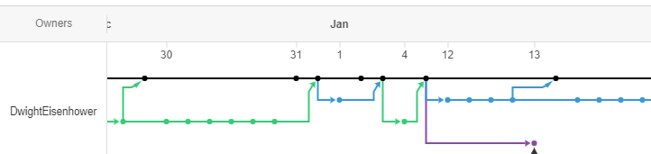

To use it, you’d have your programmer or team lead create an acc and a repo on github. Then create branches as necessary, merge them when necessary, and iron out the differences. If it helps to visualize it, here’s a picture:
I was the black master branch, green was the programmer, and blue is the other engineer. All three had branches on their PCs and when a set of changes was finalized, they made a merge request and I accepted it. What merge did is it took the obsolete files on GitHub and replaced them with more advanced files from their branch.
Now, the Vex Coding Studio is awesome and all but git can’t tell the difference between the .vcs files. So we wrote an unpack/repack program in python so that git replaces the text files that make up the Vex Coding Studio file. In the end, all one had to do after a merge is bring his local copy up to date and repack the .vcs file (though it may have been automatically replaced during every push).
