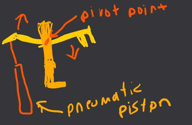

Is there a way to calculate the force of a pneumatic clamp? like a formula? We are trying to find out if we use our back 2 bar or our pneumatic clamp for auton, and the pneumatic clamp is preferred but we don’t know how strong it’s clamp is. Our pneumatic clamp looks smt like thisimage
The red is the piston we use (we fill it to 100 psi right before auton), the yellow is the clamping part
Based on Vex’s pneumatics page, the maximum force a piston can output (at 100psi) is 12lb.
When you have a pivot point, like in this situation, such a problem can typically be solved using torques. Torque is the distance from the pivot point, times the force perpendicular to the pivot point. Here, 12lbf * x, where x is your distance from the pivot point, is the torque (assuming your piston is perpendicular, or close to it, at the target clamping position).
The sum of torques has to be zero since there are no other torques around the pivot point. The force there can be calculated using 𝜏 = -12lbf * x + F_output * x2. x2 is the distance from the pivot point to the clamp. It’s negative because it’s clockwise.
Then you can solve the equation by inputting the distances between your pivot point - piston and pivot point - clamp.
𝜏 = - 12lbf * x + F_output * x2
𝜏 = 0 (since no acceleration)

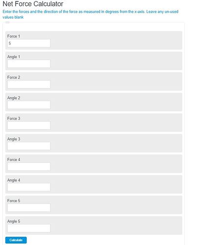

Here is a great resource that you can use to calculate the force (depends on the angle and force applied)
Use this as force
