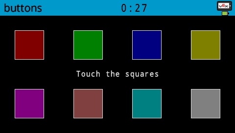

Generally for anything more than a couple of buttons you want to define a C structure or C++ object to hold the button information and state. Here is a simple example that shows several on screen buttons that can be toggled on and off.
buttons.vex (7.5 KB)
You can draw the button in anyway you would like, they don’t have to be square (although it’s generally always easier to detect in a rectangular area) and can contain text if you would like. Here is a screen shot of another demo I wrote a few months ago with two circular buttons.
do you mind sharing the source for this demo? very pretty :0
