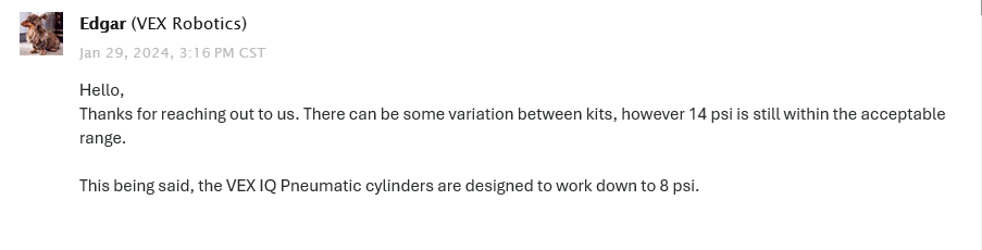

The pumps only pressurize to 17-19 psi. That’s the highest you’ll get. Cylinders designed to fire on anything above 7 psi. Double cylinders together gets you about 3lbs pushing.
That’s interesting, I had expected higher based on the reservoir being rated for 30psi. @bkahl is it true that the system will only pressurize to ~19psi?
Yes, i reached out to Vex because I had one pump running around 14PSI and cylinders going slowly. They actually responded and said verbatim even as low as 14 psi is acceptable. The highest i have seen when testing (it’s easy to add a simple air gauge in line) is 18-19psi. They responded too that we will see variation in kits too. I was able to find some of our kits were way more reliable at keeping up to 18 psi, you can hear it, and see it when robot is running. And the weaker one, all kids complain about it. If you hook up more than 2 cylinders, performance suffers on that one. So our team try’s not to use that one in competition.
