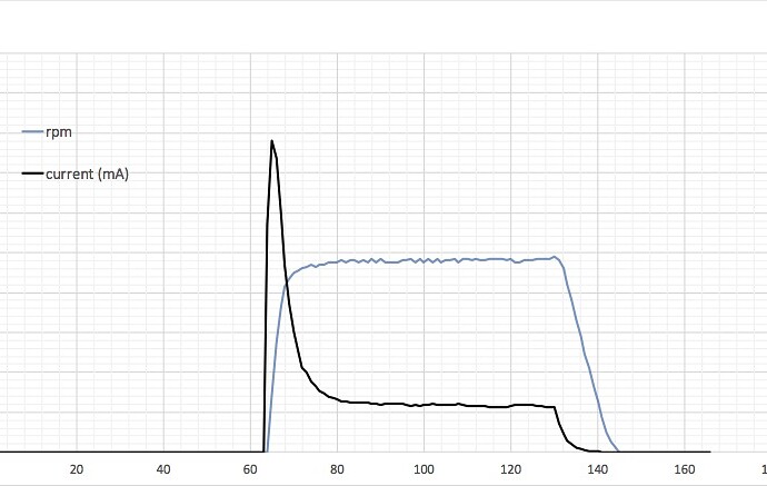

I realize that the code I’m posting is complicated for beginners, however, I’m pushing out yet another version. This is (more or less) the code I would probably use for myself. It’s the “best” algorithm from post #1 with a few extra enhancements.
  1. It uses a structure to collect all the motor related data together. The velocity calculation code takes a pointer to said structure, this allows the function to be reused for more than one motor, a deficiency of the original code.
  2. It understands quad encoders a little better and automatically sets everything up depending on how the program has been configured.
  3. It includes the estimated current calculation from my smart motor library. Knowing how much current the motor is using is useful in keeping those flywheel motors working within their limits.
code is here.
The demo shows how to configure it to monitor two independent motors.
The next step would be to add PID or TBH control variables to the motor control structure and the necessary additional functions.
Just for interest, here is the demo program logging velocity and current when I sent a control value of 100 to a single motor. Notice how the current spikes up to about 1.6A as the motor starts (this was a free running motor, no load) and then settles down to about 240mA as the motor reaches its final speed.
