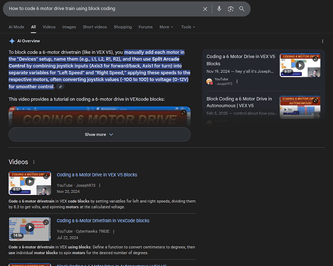

Google is your friend here. I searched the exact title of this topic, and it gave me multiple videos showing how.
Here are the links to the videos:

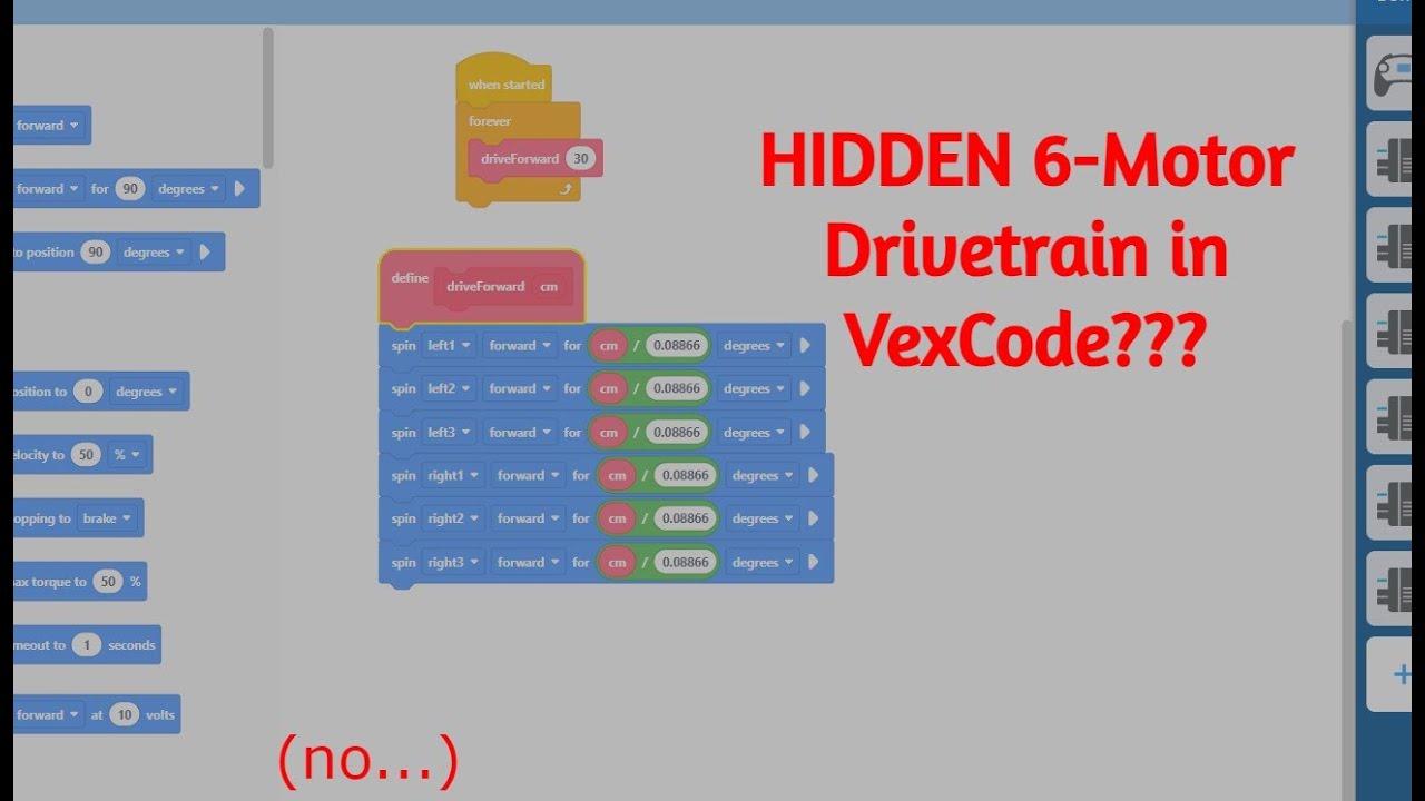

Well, you would need to manually code the otherwise automatically generated drivetrain functions. THIS IS INSANELY HARD, I DO NOT RECOMMEND IT. I suggest trying to learn python/c++, or to at least code all the rest in block before switching to python or c++ for the drivetrain. I think that in IQ and V5, at least, you can switch to python/c++ coding.
