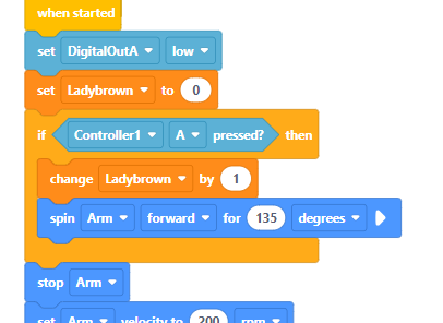

So I currently have,
But I don’t know what else to do
Or would this work better?
Yes, this should work better.

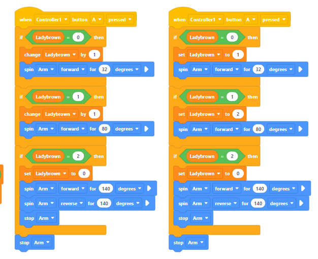

So it didnt work, but I made this
Im gonna test both
