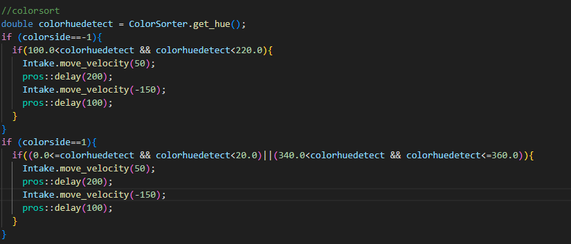

Hello, I am new to coding and my team wants to use an Optical sensor for our intake. I don’t know how to code it and need much help as possible from you guys. I wanted our intake to pick up red discs and when it picks up a blue disc the intake will go the other way. I use Vex Pros c++ so if you could help me code this, it would be greatly appreciated.

This code segment uses an optical sensor that detects ranges of colors to sort out rings during driver control. (loop not shown)
Also when I try the code, the optical sensor takes in the blue rings and doesn’t do anything thing with red rings.
Isn’t that your intended purpose for the optical sensor?
Yeah, but when it detects the red rings it should outtake and it just stops and does nothing, Thats what I meant.
Im sorry to revive this topic, but what is ‘colorside?’
Colorside is a variable that stores the current alliance color.
Could you show an example of what it looks like?
