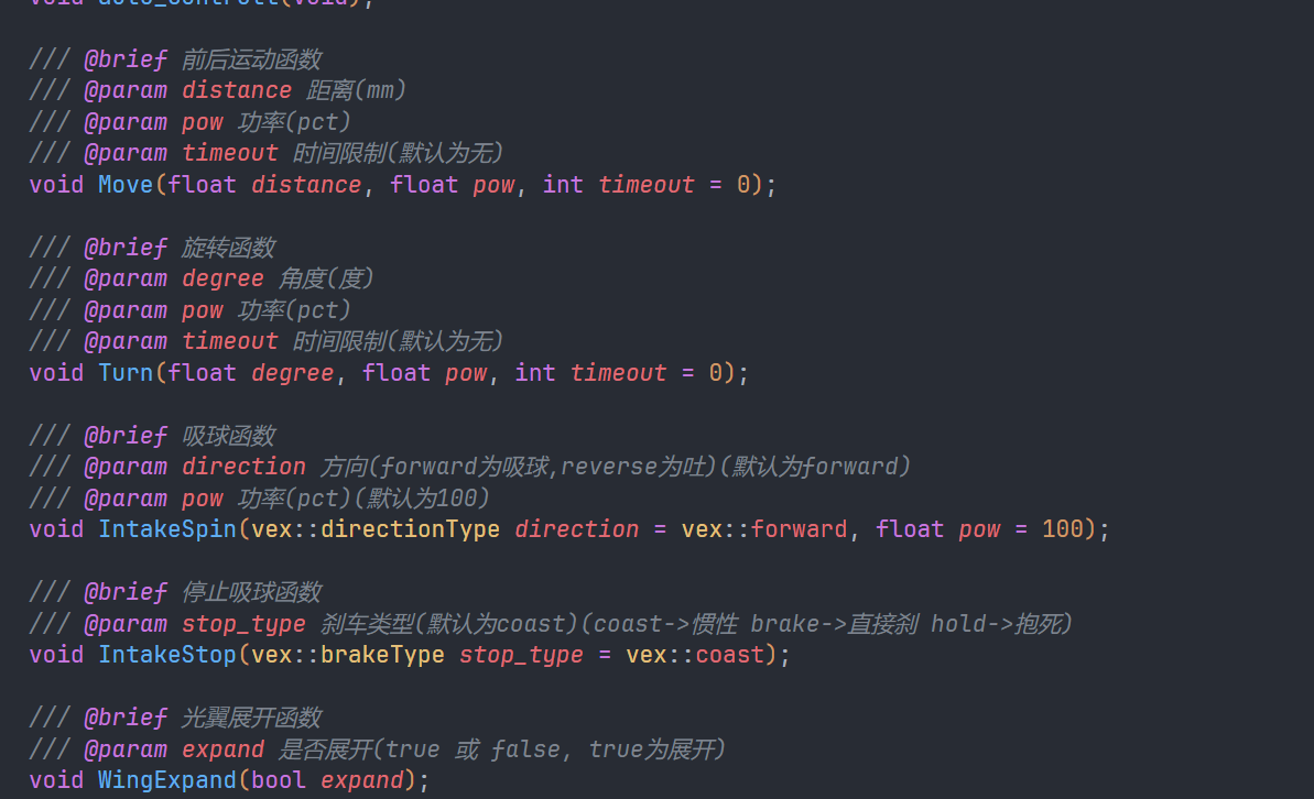

As for the autonomous part, you could simply use the internal functions that VEX has provides, like these:
屏幕截图 2023-12-17 103401
And you could view almost all these functions in VEXCode
As for me, I write some custom functions based on the offical api, such as:
Thank you for your help and feedback.
