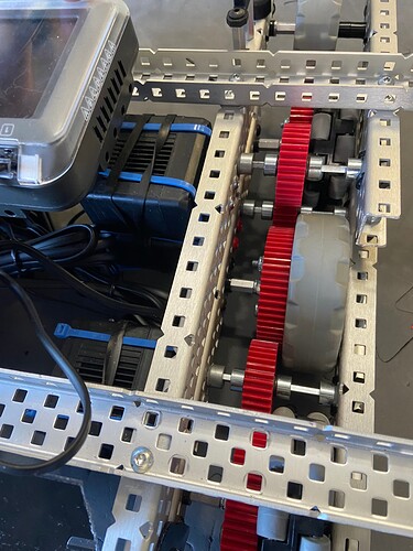

I am trying to code a 6 motor drivetrain in the VSCode vex extension, but I don’t know where to start. For reference, this is my drivetrain right now:
I am also trying to make the robot driven using split control.
Off topic, but your shafts could use some spacers instead of shaft collars. They will save you a lot of weight. If you do it right, you only need 1 shaft collar per shaft.
