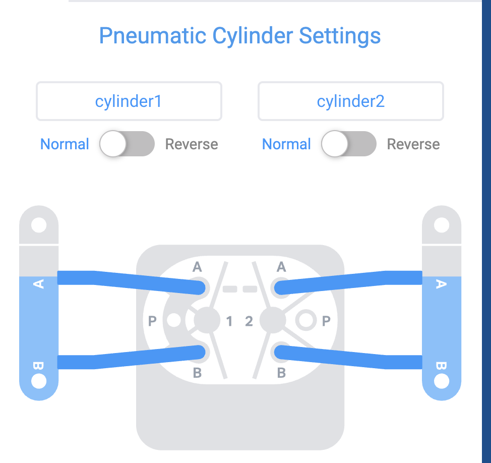

Add a pneumatic device by clicking the chip icon in the top right corner
Screenshot 2025-04-18 at 3.26.02 PM
looks like that
click on add a device and select pneumatic, the select the port you plugged the pneumatic in
set it up and then exit out of the devices screen

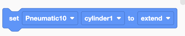

select motion on the left hand side and drag this block to your code

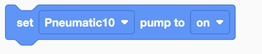

use this one to start the pump
