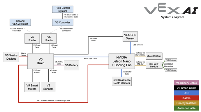

here 's my problem:
the dashboard’s fps is about 5 or 7
but the github-readme said that the processing fps is about 30.
so how many packets the jetson nano send back per second?
Yeah, The problem here is just that the Jetson software is SUPER OLD and deprecated which makes it super slow and inefficient. Basically, the Jetson sucks a lot and can’t handle anything. We are starting to try to move towards Raspi since there is no requirement for using the Jetson.
Nice! I can see that you established your vex link between two robots. However I don’t see any communication between the Jetson and the v5 brain. Check to make sure that all the cables you are using are data cables and are plugged all the way in.
(I know this is probably not your issue, but it couldn’t hurt to try)
How do I identify a data cable?
the easiest way is by checking if the cable also works to download a vex code project to your brain
So besides the cable connecting the V5 brain to the Jetson for power, should there be another cable connecting them 2?
Yes, a usb cable

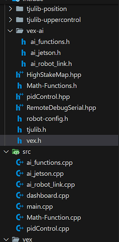

i have another question sir.
after building a vex-ai demo ,i want to merge my own code with the ai demo.
but later,i want to receive packet from jetson nano as usual.i failed.
would you please help me figure it out?
here is the main.cpp

Is this still an issue? If so, did your code throw an error or did the brain simply show nothing? (did your code still run?)
Hi, i am having the same issue, i write my code but robot is not move at all. i do have input data from GPS sensor and it shows on the brain. and i also realize my jetson is not talking my brain, i connected everything up. I want to know what is the correct way of coding for vexai, it seems like i cannot code on the sd card and plug it in to jetson when i am done coding. because the brain will not run what i coded.
i have same problem. how to connect brain with jetson. i got all the wiring
