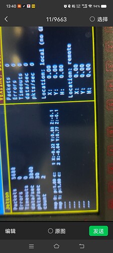

ok , here is my problem。i can receive packet from jetson。
but i want to code the ai-demo to achieve “printing “detected” while the camera find objection” but failed. would you please help me?
in another word.i want to find the information in the v5 brain.i print all the data in the “local_map” but find nothing.
i connect everything and find dashboard on the internet(through the jetson wifi
this is my brain picture
i have detected the objection and send back the packet and the data.
but i failed to print it on my vscode
in order to offer you more information about my situation.
here is my ai-demo’s github link
cv-computer-visual-tj/vex_ai视觉方案/vex_ai_24_25 at main · tj-messi/cv-computer-visual-tj (github.com)
all i want to do is print the data on vscode.and then based on the data the camera founded.i want to make some decisions automaticially
but now,i failed to print,so please help me

Start simple with just a motor that’s spins if an object is detected. In the meantime I will take a look at you code and help out :slightly_smiling_face:
