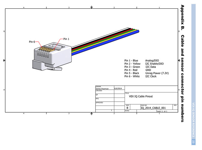

You would need to build a special cable (ie. modify an IQ cable) and you could then use serial communication between two brains. Ports 1, 6, 7 and 12 on a gen 2 brain have this capability, but it’s not really documented. The easiest API is probably to use standard C fileio, open a port as “/dev/port1” etc. and then use read and write.
In terms of the cable.
I would disconnect wires going to pins 1, 2 and 5.
Then pins 3 and 6 need to be swapped (ie it becomes a crossover cable).
When configured as serial, I2C clock becomes TxD and I2C data becomes RxD.
I’ve not tried this between two IQ brains, only from a brain to other device such as an Arduino, but it should work.

Here’s a very simple demo using two IQ2 brains. crossover cable (swap scl/sda) with gnd is needed, disconnect power and the other signals.
One sends (well, technically they both send in this demo) the string “Hello” the other is receiving it.
Here is the C++ code, in practice for reliable communication you need to invent a suitable protocol handling partial reception of data, error checking etc.
