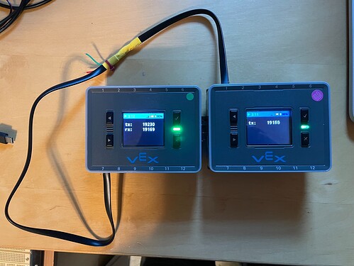

How to connect one or more VIQ brains to each other
Here’s a very simple demo using two IQ2 brains. crossover cable (swap scl/sda) with gnd is needed, disconnect power and the other signals.
One sends (well, technically they both send in this demo) the string “Hello” the other is receiving it.
Here is the C++ code, in practice for reliable communication you need to invent a suitable protocol handling partial reception of data, error checking etc.
C++ demo code
