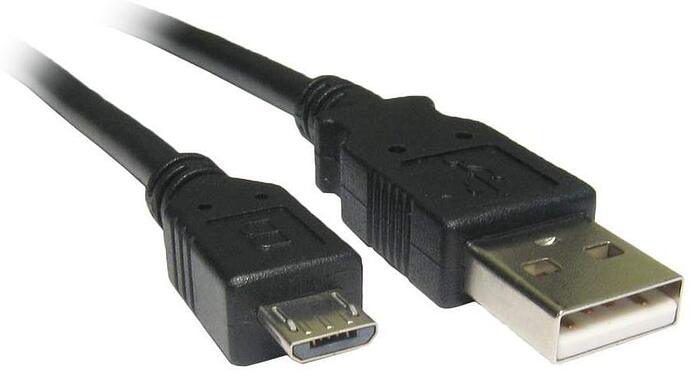

So you plug a usb cable into your computer, then to your brain. On the side where you plug the battery cable. There is a port that looks like a trapezoid. Plug that in and on your program. It should show controller and brain icon green. Then You click download. You can alos download from the controller. On the bottom of the controller. There is the same shape and you plug into that instead of the brain. But make sure both the Brain and Controller along with the vex net key are on and connected.
This is the USB.
