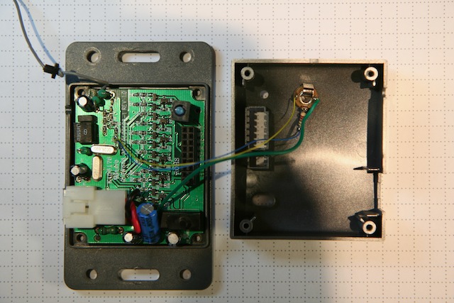

The VEXplorer microcontroller has a 27MHz receiver that feeds a signal through a resistor (R12) to a small microprocessor that decodes it and generates individual PWM signals for the motors. I added a standard 1/8" (3.5mm) audio jack with a built-in switch to select between the normal 27MHz receiver and an external signal. Here is a block-diagram of the mod:
Before:
[INDENT][ATTACH]1181[/ATTACH][/INDENT]
After:
[INDENT][ATTACH]1176[/ATTACH][/INDENT]
The PPM4VEX library also has to change, because there are 8 signal channels instead of 6 (2 of them are ignored), and the channel order is different. Other than tweaking these constants a bit, the code is otherwise the same.

[ATTACH]1186[/ATTACH]
