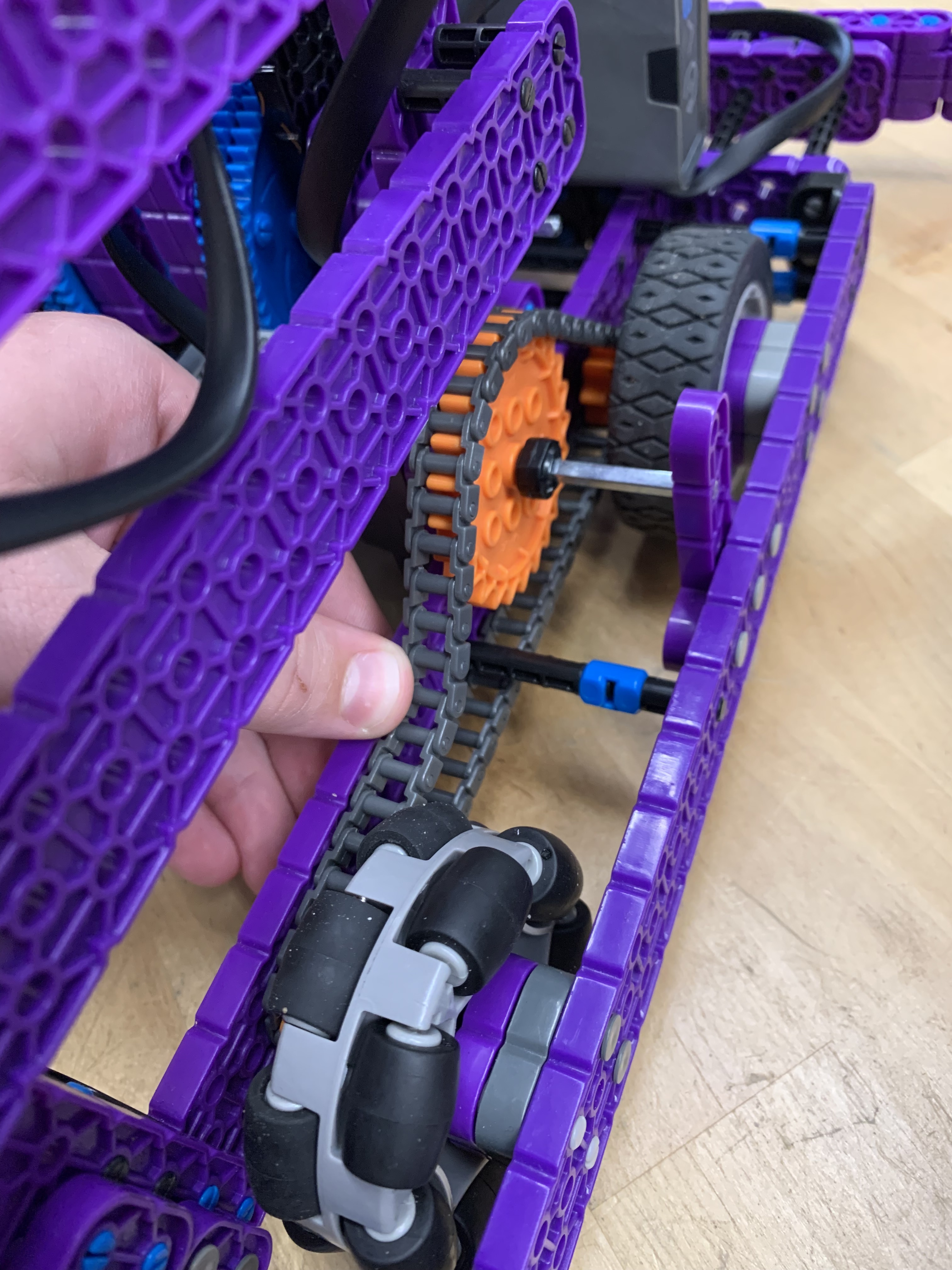

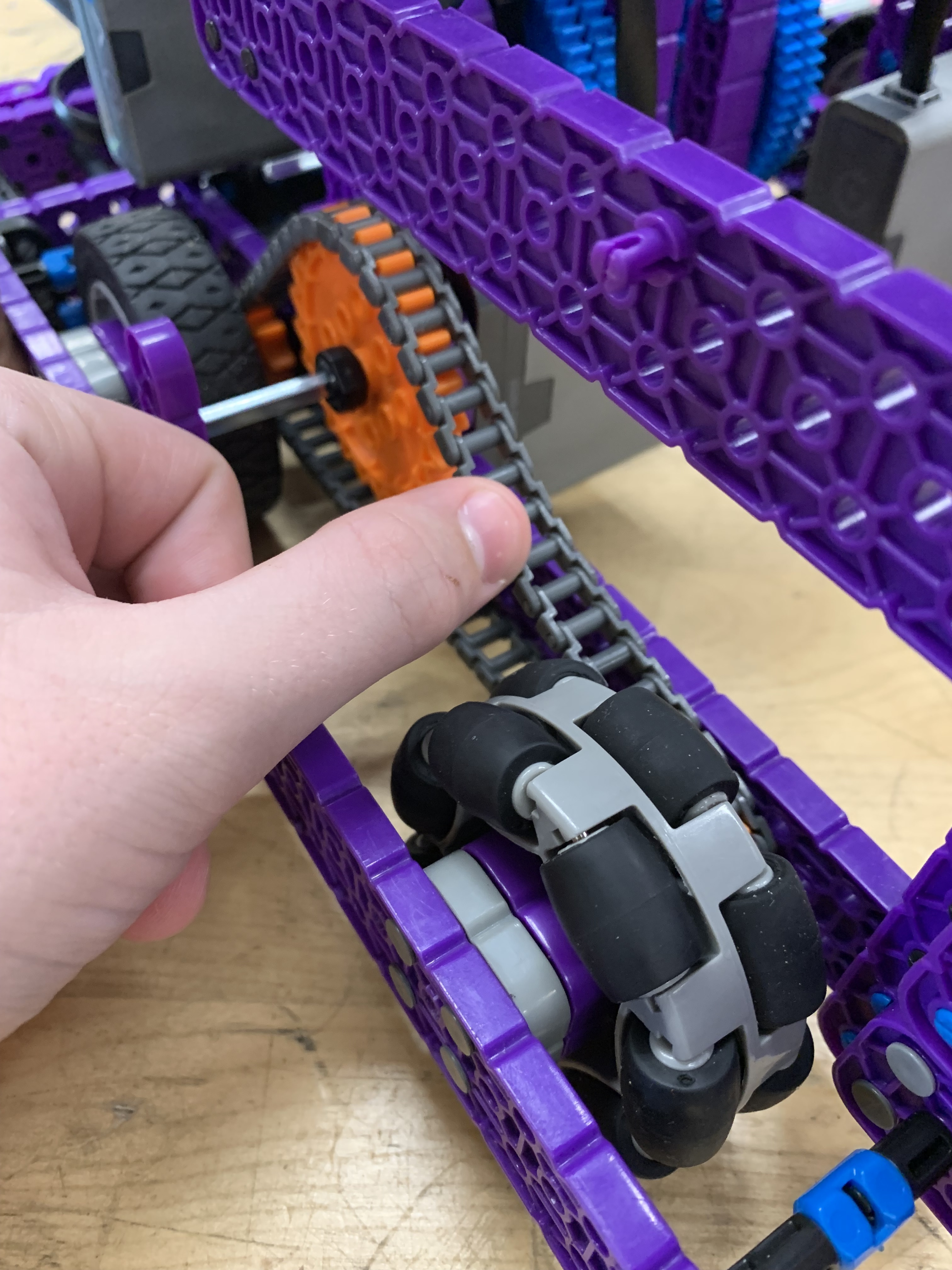

Here are some photos that might help
That looks like you have quite a bit of slack and could remove a few links. Another option could be to run the bottom portion of the chain over that standoff across the middle. We use standoffs to add tension to the chains when removing links aren’t an option or if we have to run the chain through some weird angles.

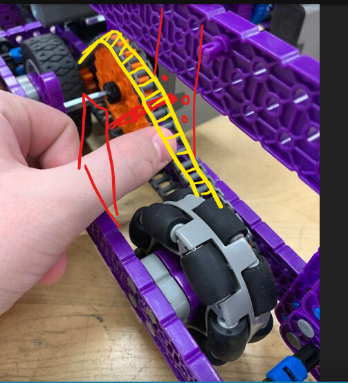

Run a 1x beam from the plate that holds the wheels to the one above it. then use a 3x or 4x standoff as a guide. The idea would be as the chain comes off the orange sprocket use the standoff about where your thumb is as a tension device to hold the chain down.

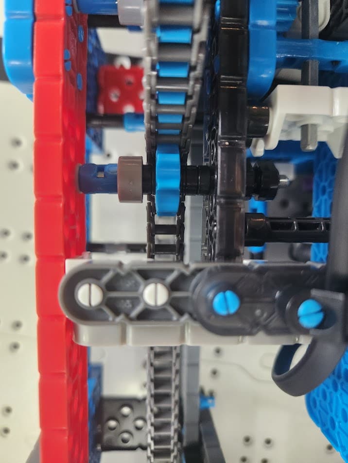

I tried a simmilar method of tensioning chain and I had a large loss of torque.
@Vibots_702b , just make sure that the chain isn’t too tight when tensioning and watch the wrap angle of the sprockets (more about that here) Anyways, good luck!
I’ve tried tensioning with support bars and removing links but even removing one link made it too tight and the bar got grounded down a little due to friction so we just fixed it by changing the motor location and drive train speed
If it’s too tight and creates too much friction that can happen. From your picture you have a gear on a shaft with lots of pieces, not just a single shaft. The OP was looking for a way to help tighten it and get some extra wrap to engage more teeth.
looks like you have enoughf chain there to remove a link. if not just add a tensioner. so just like a stnadoff sticking off of a pice o plate.
red prepresents plates you can add and a standoff and yellow is the chain going over the standoff eating up the slack.
