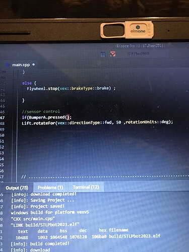

I am having issues with my bumper sensor program. When the bumper is pressed once, I want it to rotate a motor. The program keeps calling for a “callback” to be specified but I have no clue what this means. Anyone have any suggestions?
BuperA.pressed() sets up a callback. A callback is a function that runs if an event happens. In order to use a callback, you need to place the code that you want to run into a function like this

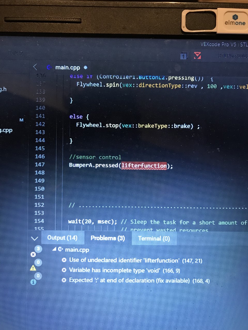

Yes, I had this exact same problem. what you need to do is create a subroutine (void), that specifies the task you want, and then have the button.pressed() call that subroutine.
void (lifterfunction){
Lift.rotateFor(vex::directionType::fwd, 50 , rotationUnits::deg);
BumperA.pressed(lifterfunction);
(note, I may have some of the exact syntax wrong for the subroutine, but I’m sure you know how to do that). Also note: The Button.pressed() command is not a loop, it is its own command. So don’t use “if”. It will run as if it was a conditional loop but you have to set it up like I showed.
Use
if (BumperA.pressing()){
//code you want to execute here
try using this instead:
if(BumperA.pressing())
//Code to run when pressed
.pressed() is completely different. It doesn’t return a boolean value, rather it sets up a callback which can be thought of as a function that is called whenever the button is pressed. Here is a use case for .pressed():

You are doing the if statement incorrectly. You need to put brackets instead of a semicolon. Like this ‘’’if(bumperA.pressed()){
Lift.rotateFor(fwd,50,degrees);
It wants you to have it call a function whenever you run button.pressed(), but if you run button.pressing() then it returns true if the button is pressing and false if the button isn’t pressed
I think you are defining your subroutine too low down. I believe it needs to be right under where it says “using namespace” Here’s a better example. I know this one works:
void lifter() {
Motor1.spin(forward);
int main() {
Controller1.ButtonR1.pressed(lifter);
