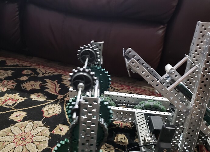

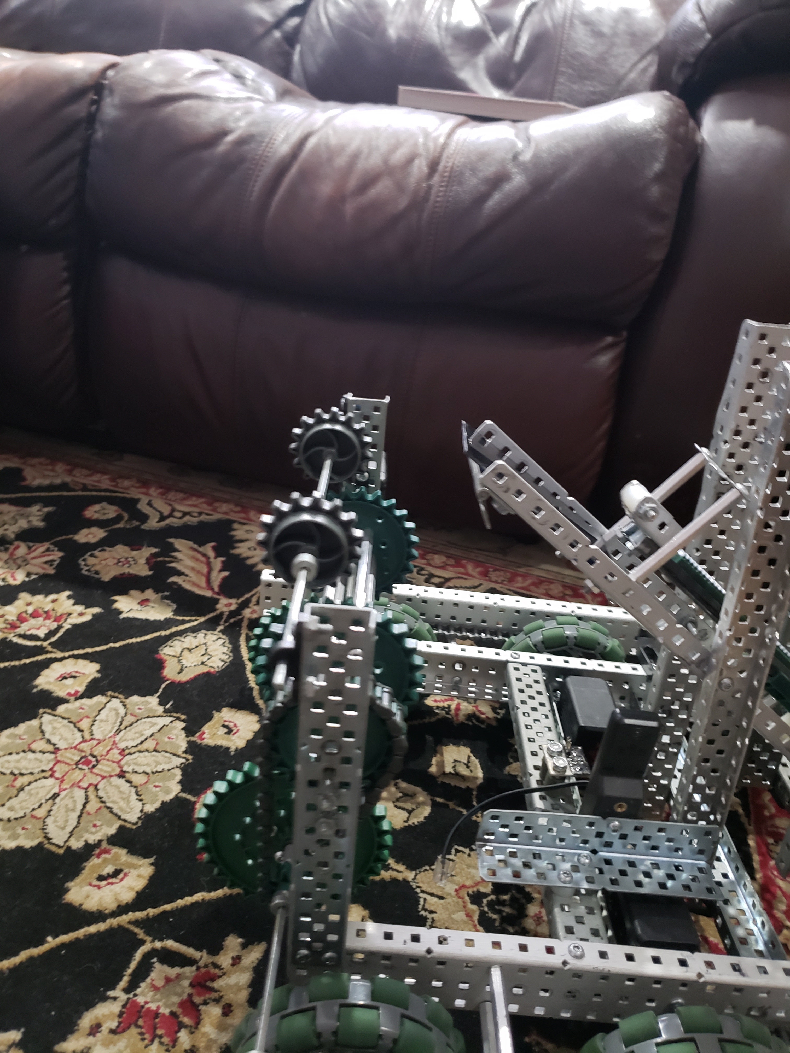

I’m building an intake for my robot, and in order to get the top set of sprockets to roll the ball on to my puncher, I need it to spin the other way. How do I accomplish this while running it off the same motor as the other two levels? See picture attached.
I am a little confused about the question but I can tell you this. there is no good way that I am aware of to use sprockets and chain to make 2 axles spin in opposite directions. you would normally use gears to do that. once geared, you could sprocket and chain the power to another further away axle and get what I believe is your desired effect.

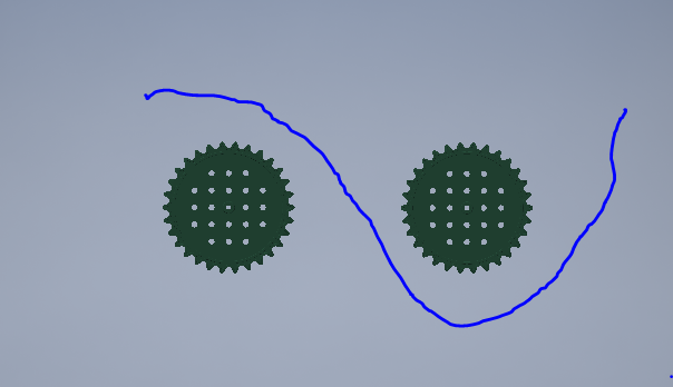

I was on my phone earlier, I’m now on my laptop. Here is an inventor sketch of what I’m talking about:
blue = chain
Thanks for the help! I believe that the two axles might be close enough for just gearing them, but I’ll take a look at the serpentine system too.
That system doesnt work very well with the chain that vex uses. It is too thick especially for short distances.
It works pretty well. I sometimes use a standoff instead of the second sprocket even.

I know this is super late, but how do you connect the chain together with that design? they can’t overlap in the center…?
Plz don’t revive old threads
I think it is fine reviving this one as it is relevant to the topic and the thread isn’t super old. If you were to use that design you would need more sprocket’s not shown in the picture to link the chain together, overall probably not worth it in all or almost all situations.
@DRow I think this needs a lock
No, it doesn’t. It’s a valid question.
One would need a third sprocket or a roller or something for the chain to be able to link. It wouldn’t be that hard to do, just an idler sprocket.
