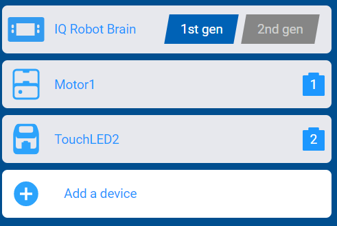

Here is a sample program using a Touch LED and a Motor. There are similar examples in the Example link under the VexIQCode File menu.
Configuration:
Code example using the when TouchLED hat
