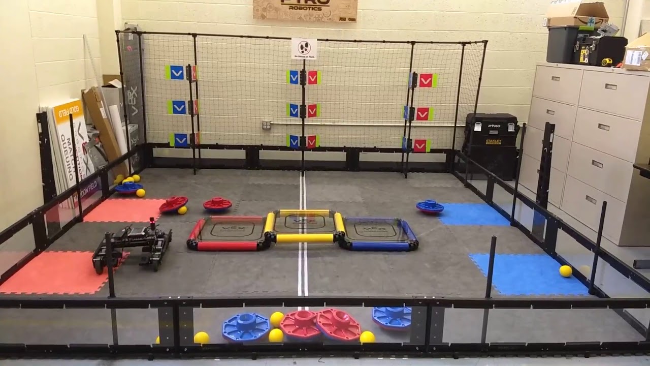

Y’all think it’s impossible to get over a wall- but y’all have forgotten the dark magic of the bogie drive
Will a robot with a bogie drive so severely elevated to climb over a 3+" sheer wall actually be able to navigate the field, collect cubes, and score stacks in the first place? I think it’s possible to build a drive that can surmount a wall, but I also think any such drive will be absolutely terrible in normal competition.
Best part? If I’m understanding R1 correctly, you can’t legally switch out drivebases during a competition, so the “bogie base only against wallbots” option doesn’t hold any water.

Wow, I hadn’t seen that video before - looks like a 5" climbing bogie drive is very feasible from the drive perspective. My concern is about the stack of cubes such a robot would need to carry. How much clamping force would you need to exert on the cubes to keep them together with that big of a jolt?
If I were the wallbot playing against a bogie drive like that one, I would probably concentrate the defensive pressure on that robot and hope that that was enough to stop you.
Are there any weaknesses of a bogie drive that a wallbot could exploit? I’m not very familiar with the design, but my assumption is that it must have some drawbacks since it doesn’t seem to be very prevalent. Is it just the complexity added for comparatively little gain that makes a bogie drive usually unappealing? I would honestly love to see a “wallbot climber” robot design this year. Robots that are explicitly designed to beat wallbots are definitely a legitimate threat. However, if there are only a few top teams willing to take the risk of building a wallbot, then I imagine there would be even fewer teams willing to put in the extra effort to build an anti-wallbot robot.
