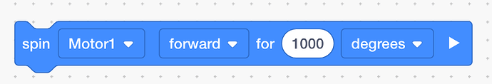

I am using the X button and the while command to spin the motor. The thing is I want the motor to stop after 1000 degrees. How can I do that?
If using VEXcode V5 text, motor::rotateFor is your friend here.
If using VEXcode V5 blocks, you can use this block:
