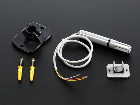

Here is the humidity sensor:
(Can I get both temp and humidity?)

Calling sensor.get_value() method (VCS, PROS) would only work for analog sensors that output measurement as voltage between 0 and 5v.
Both sensors that you have linked to only have I2C interface, which I don’t believe V5 has native support for, unlike previous generation Cortex.

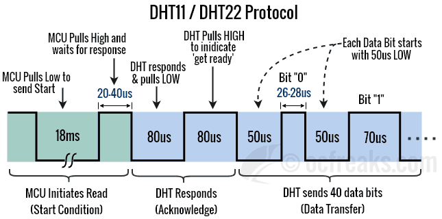

V5 legacy 3-wire ports (ADI) are connected to a separate co-processor which runs its own firmware and reports raw analog and digital values to the main processor only about each 10 ms:
I don’t think this is fast enough to bit bang I2C or any custom protocol, like the one used by DHT11.
Do you really need to use V5? It would be so much easier to connect those sensors to a cheap Arduino or ESP8266/32 board.

but requires careful timing to grab data

25-80us bit timing is well below the 10ms minimum delay that legacy port co-processor has in communicating with V5 main processor.

I would suggest you to get an Arduino nano or mini. Use it to read and filter sensor data, and then relay it slowly to V5 brain using a protocol similar to DHT11/22 linked above but at much slower rate. This way you could reuse DHT library code with minor modifications to make it about 1000 times slower to work with V5.
