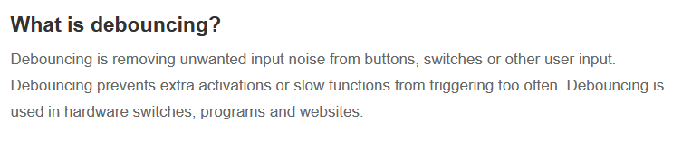

You could also add a delay of 1-2 seconds in case you accidentally press the button twice. It will ignore all presses except for the first one.
This is called debouncing.
