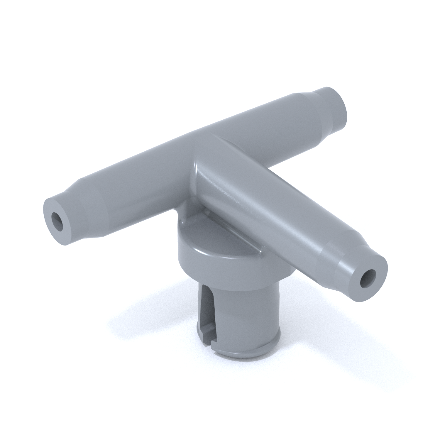

Me and my team are using pneumatics. I am not sure how to use multiple Pneumatic Solenoid. Please help!
What do you need help with exactly? Programming or actually hooking them up to the robot?
Figuring out how to attach another pneumatic solenoid
In your supplies, you should have a “Tee” fitting. Put this in your air supply hose between your pressure regulator (or your air tank if you’re not using a pressure regulator) and your existing solenoid, then run the branch of the “tee” fitting to your second solenoid.
Use the “tee fitting” to split the pressurized air between two paths, one to one solenoid, another to the other one.
