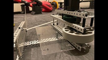

Vertical (or we normally called it single) flywheel:

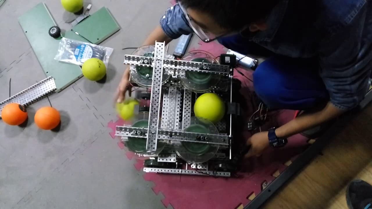

Double (which is also a kind of horizontal) flywheel:

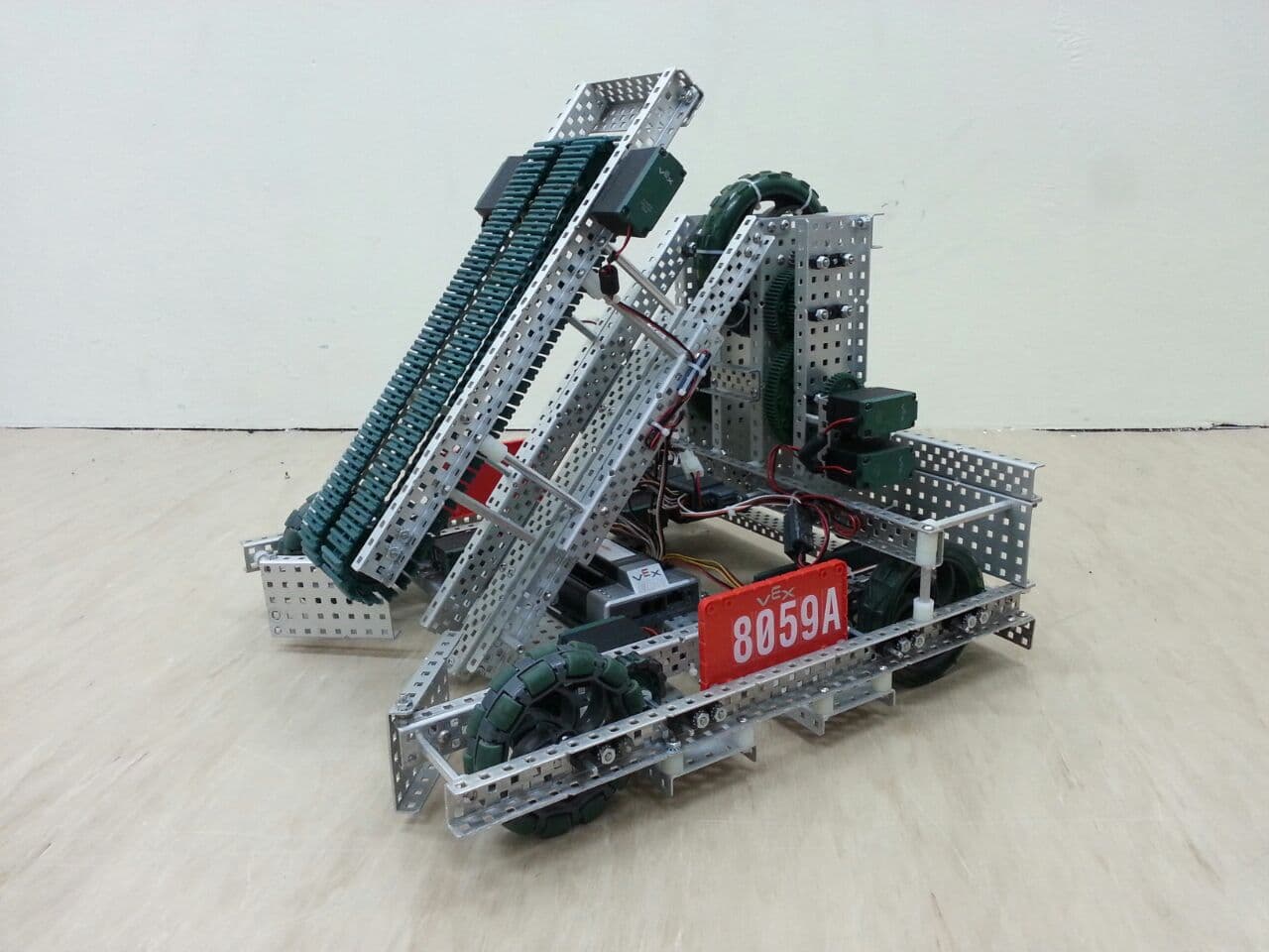

The current season horizontal flywheel (with only wheel):
