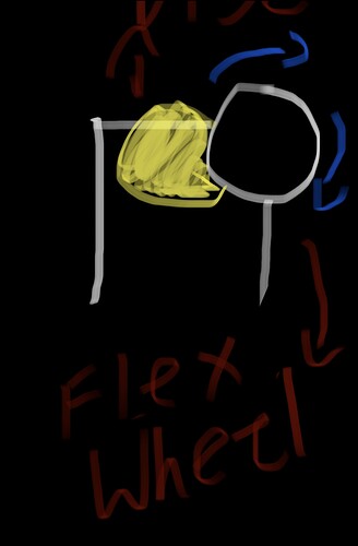

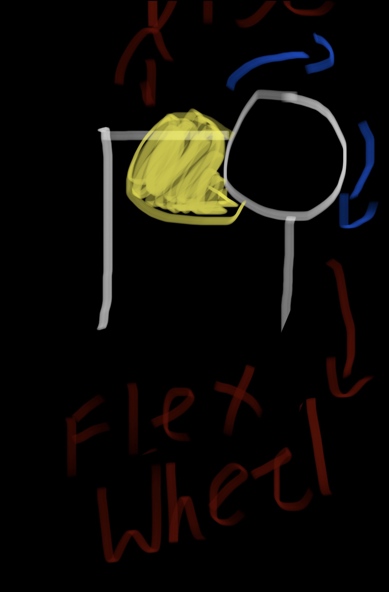

My idea is a little iffy but most teams that I’ve seen on videos on have similar ideas soooo, I don’t really know
Ya. that should work but I would suggest feeding it at a 90 degree angle
I had this idea as well, but its probably not necessary.

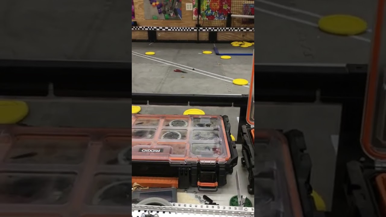

no flex wheel
isn’t that too much spin on the disk?
When the disk hit the wall, it just flew out meters.
Just an observation.
Yeah it’s moving pretty good. Simply showing that flex wheel not required for launching.
