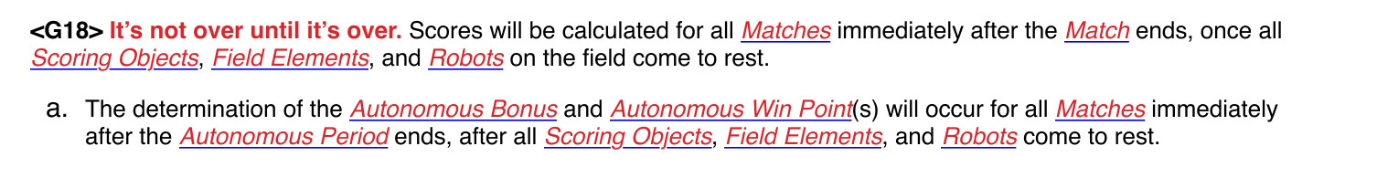

In a game and the game ends the motors release and it doesn't keep a fixed position

It’s not a programming issue, the code shuts off at the end of the match so this is already just out of the question. You need something to keep the motor from spinning even after the end of the match when it is automatically set to coast. The easiest way in my opinion would be finding the right gear ratio to make it hold when the motor isn’t moving. You would just have to mess around with different high torque gear ratios until you get one that holds when you have the weight of a MOGO.
On that note, I’m wondering if the platform tips after time is up, would referees score as the platform was right before the match end bell rang, or how it settles at the end of the match? Does the manual have anything about that?
According to G18, They score it as whatever it is when all scoring objects, field elements, and robots come to rest, so it would count as how it settles at the end of the match.

So, from my interpretation of the rule, the referees will score at t+3 or later.
