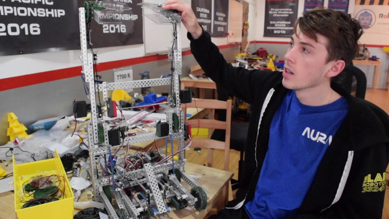

Could someone explain to me how exactly an indexer mechanism works?
An indexer keeps the balls from entering the flywheel until you’re ready to shoot. This makes driving and autonomous easier and allows your flywheel to spin all match without constantly speeding up and slowing down.
Sure! One easy way to do it is to gear the chain and the intake roller opposite directions, as the BNS and 6007 RI3D team did. Here’s how that works.
