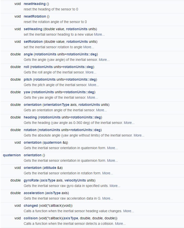

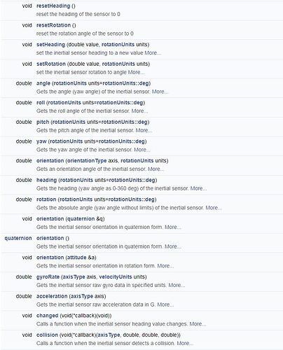

and how would you make a pid off of values of thr inertial sensor
Ok so I found some values, would it be possible to use acceleration?
Integrating the acceleration from the inertial would not be very accurate as the refresh rate is 50ms but using either heading or rotation will work. You would do it just like any other pid with your current position being whatever the inertial sensor is reading. And you don’t have to use multiple sensors its just a way to help accuracy.
