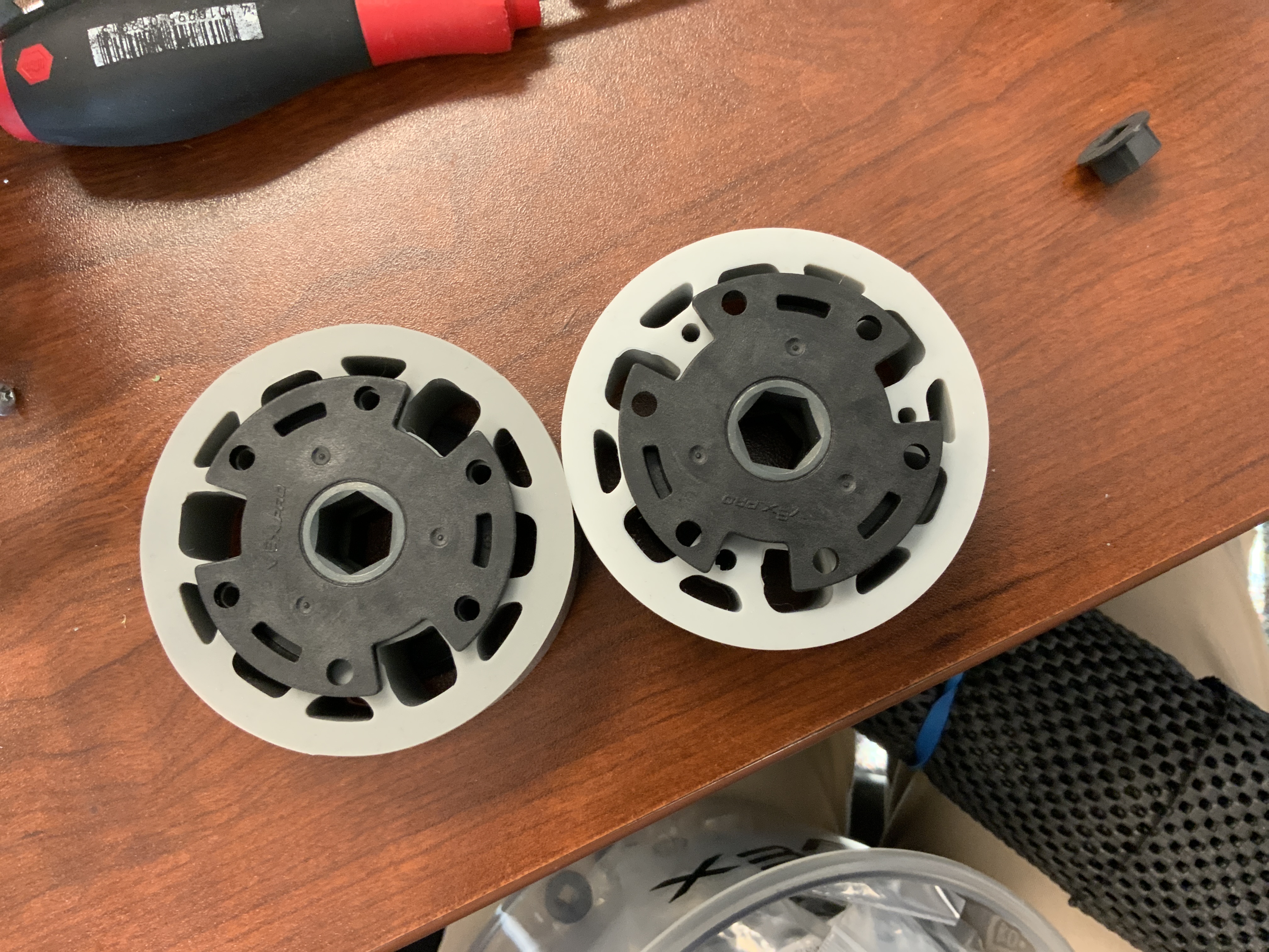

I need help making my intake, do u use axles for these flex wheels. Im trying to make an intake, for triballs.
You need to use the Hex adaptors along with the hs>ls axle insert.
This is one of the hex adaptors: (There’s also one to the right in your photo.)

This is the hs>ls insert: (what you use in normal wheels)
You put the hex adaptor in the versa hub, and then the shaft insert in the hex adaptor. (unless you are using a high strength axle, in that case you don’t need the insert.)
Hope this helps!
- Henry 344E
For flex wheels, you add the versa hax adapter then the larger to smaller axle adapter then you can use the flex wheels on an axle.
Also, I would suggest adding screws to the versa hubs so they don’t fall off.
