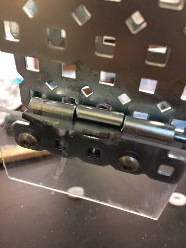

I used hinge to make a hook, when the cube goes into the intake the hook automatically holds it.
ah… clever. Thanks for sharing!
How would you let go of the cubes tho?
I plan to use pneumatic to release the cubes. I’m going to use hinges to connect the two 1x35 c channel to the rest of the intake, so the 1x35 c channels will act as gates that hold the cubes in the intake. When the cylinders retract the “gates” will open, so the cubes can come out.
I find it hard to explain my idea in words, I’ll post another video in a few days.
