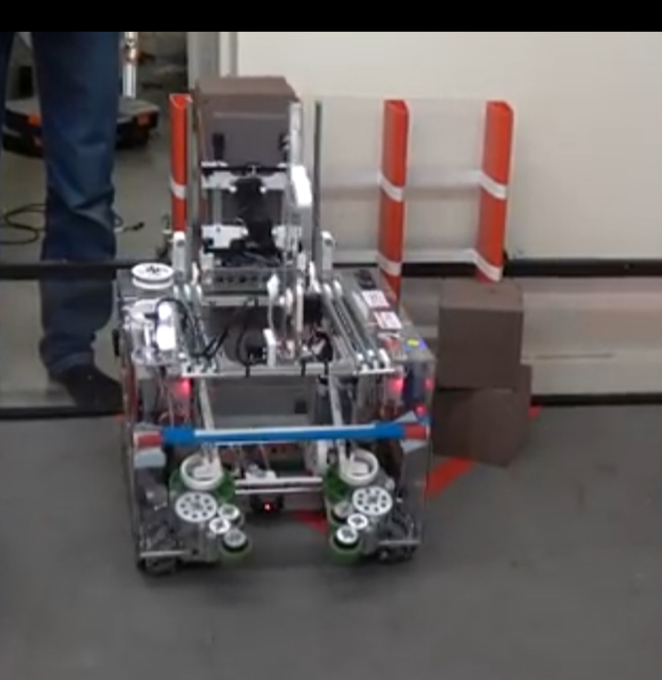

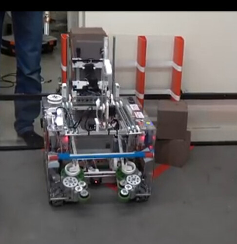

I’ve been looking at Skyrise intakes and thinking about building one until I saw this post:
Due to how slippery this season’s cubes are, will a 4-cube conveyor still work?
I’m definitely like a dual-tracked intake that transfers cubes into a passive cube stack holder. flaps are what keep the cubes from slipping out.
sort of like the one in the extended reverse stacker video.

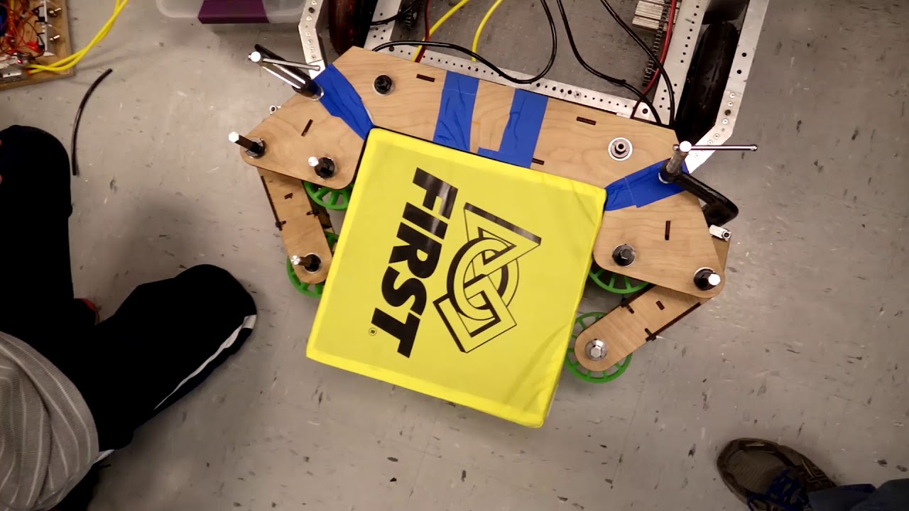

Make sure you design an intake that can pick up cubes from a variety of angles, reorienting them into a known angle, which should allow for you to make uniform stacks. There are a lot of examples if you look at the designs from the 2015 and 2018 FRC Games.
The problem I see with this design is the amount of space the intake would take up. While you would be able to intake and stack fairly well, how would you place cubes in towers. You would need a second arm which would be difficult to fit on top of this mechanism assuming it had to at some point go vertical to stack the cubes. Also, you would only be able to hold 3 cubes at a time with the 18" width restriction unless you were to use a motor to extend the intake.
The intake doesn’t have to be exactly like that. You could store the cubes however you would like to. The point of showing that video was to demonstrate how helpful it is to be able to pick up cubes from any angle, not necessarily store the cubes like that.

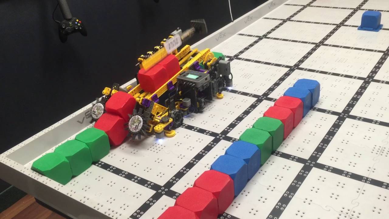

I’m working on a passive intake system, here are some videos:
I’d love to know what’s holding the cubes in.
